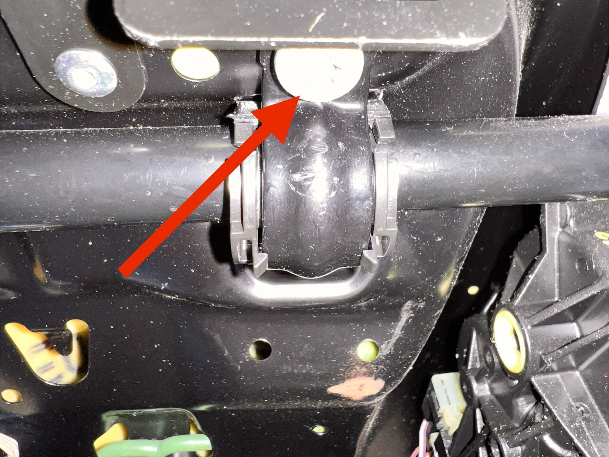

Next, you’ll loosen the seat bottom to move it out of the way, but you won’t console try detach it since it’s not necessary. It’s only held on by two screws under the front part of the seat, hidden by the storage bin you just removed. Here’s one of the screws. It’s attached to a C-clamp that wraps around a horizontal rod. It’s really easy to see when you remove the storage bin
