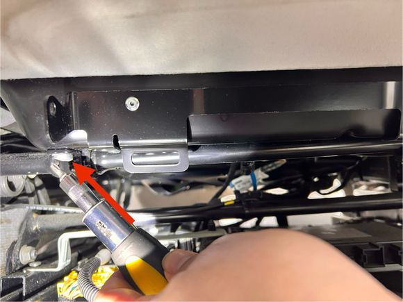

hecdog February 9, 2024
Here’s the second screw/C-clamp. My short screw driver was too long so I used a 1/4” socket and inserted the t25 bit into the 1/4” socket to unscrew this. Super easy but took some torque to loosen it.
