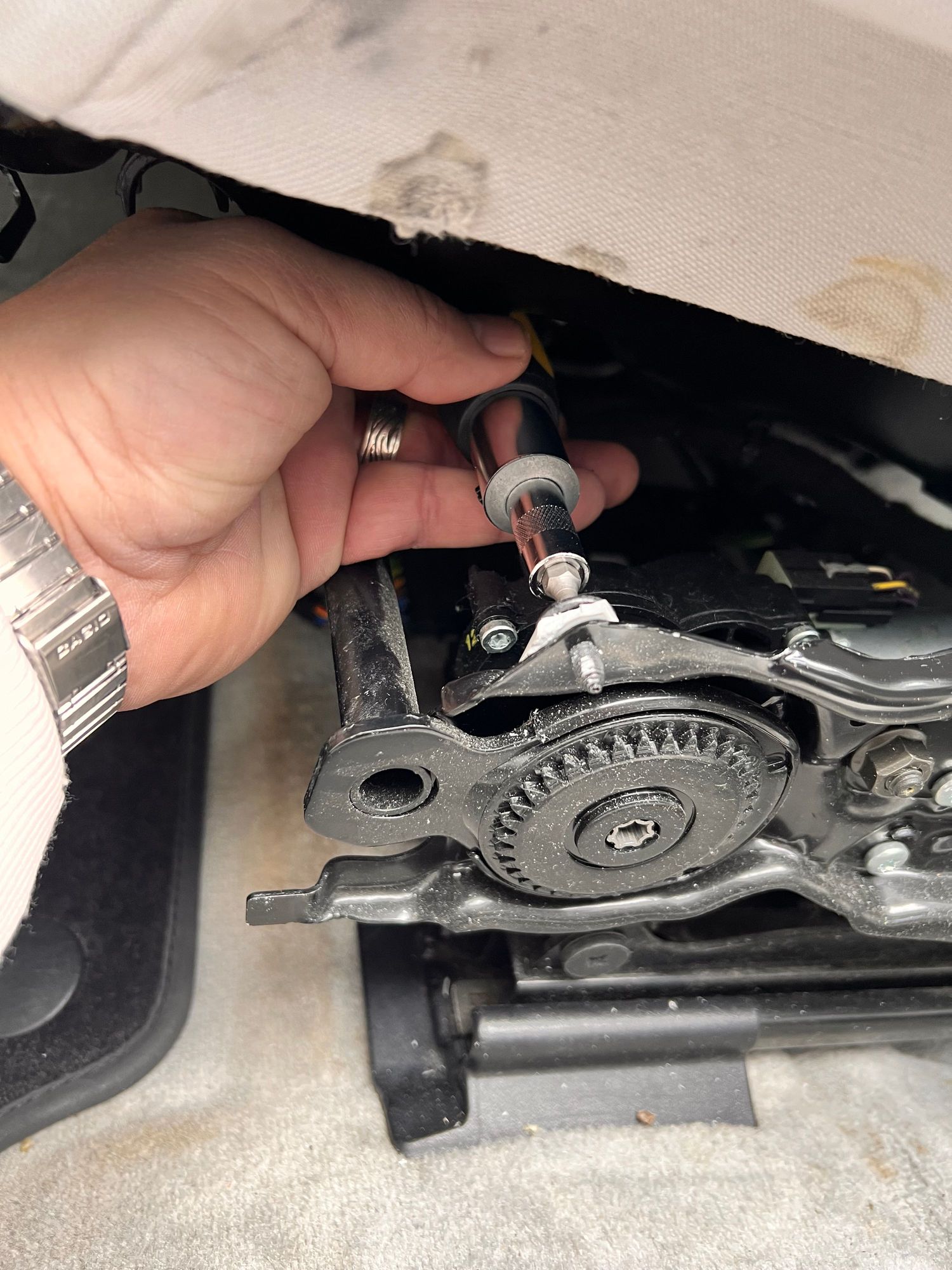

If yours isn’t broken like mine was, you’ll have to remove this second screw which holds the trim piece to the seat frame. So in summary, there are two 8mm screws holding the air bag to the seat frame, and 2 t25 screws holding the trim piece to the same seat frame.
