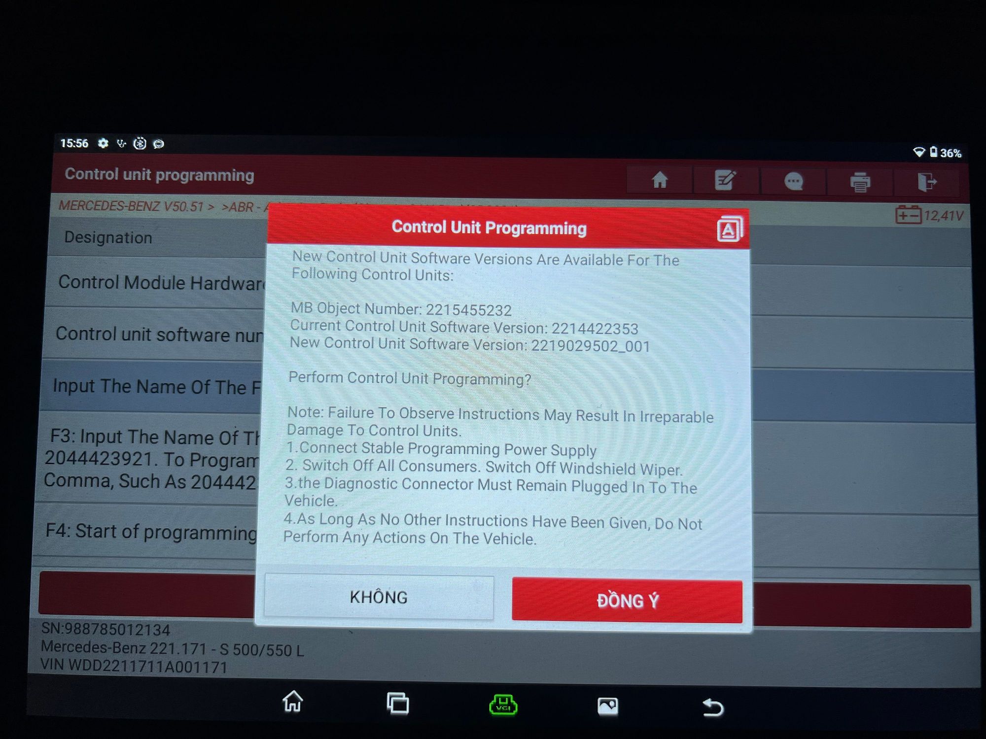

The ESP from W221 diesel donnor then therefore Cruise Control does not work when it installed in my car. I hope 2219029502 is the right SW for my W221 RWD equipped with M273 engine + Distronic Plus. New SW flashing is successfully completed and ai have no time to test cruise control yet but I think it should works.
