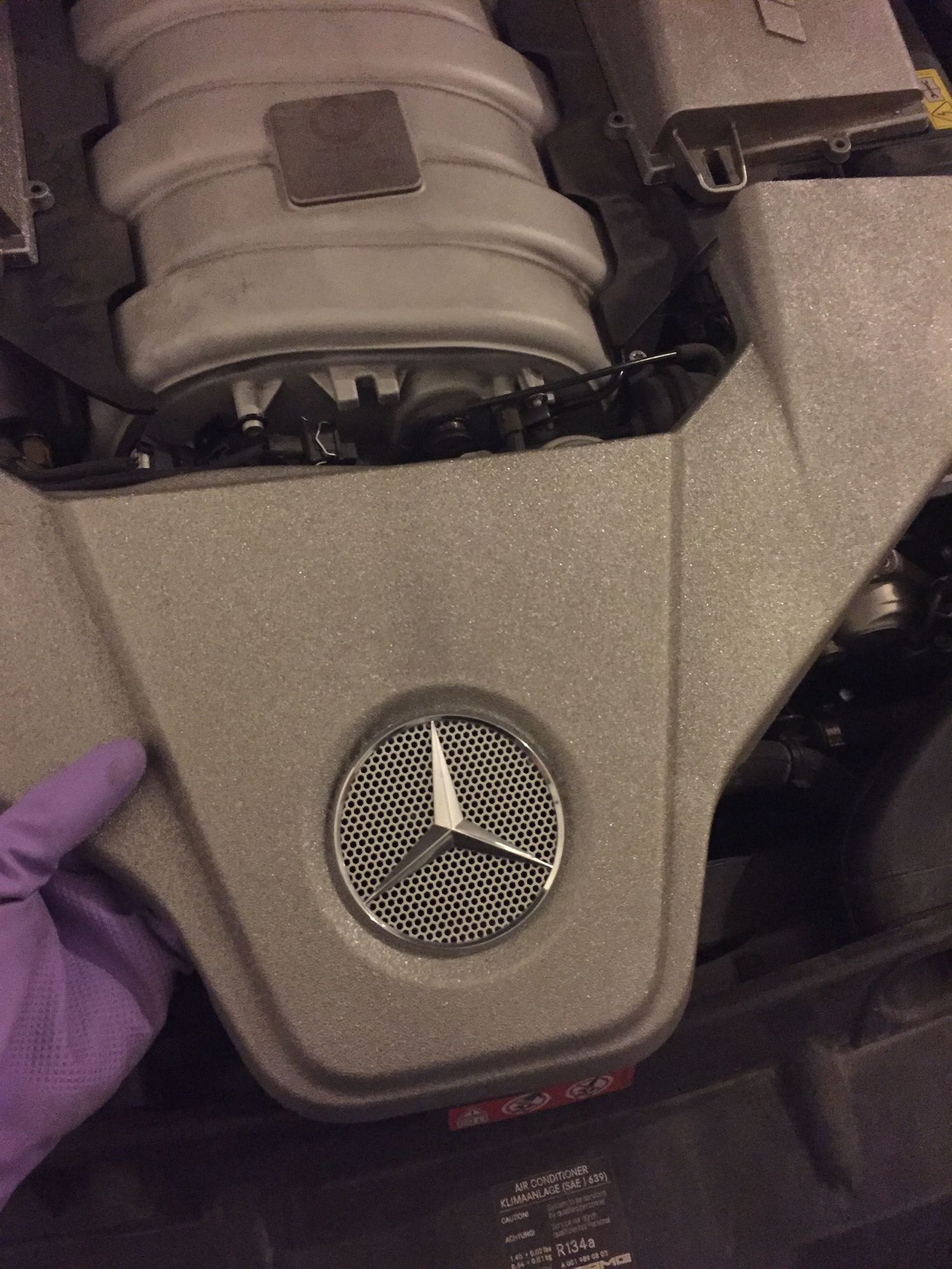

Front panel has two clips near the oil filter, two clips by the lids on each side,,,,lift up and it pops...6 total clips to remove this panel (easy)
