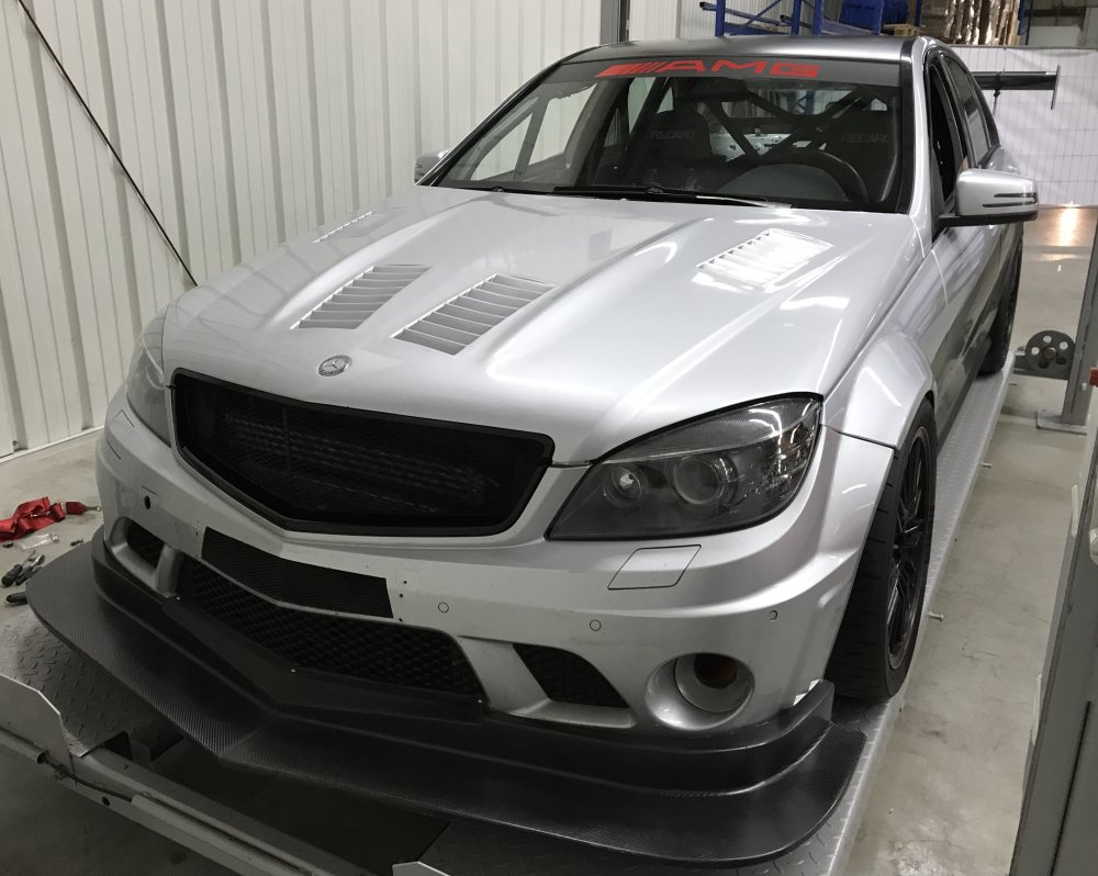

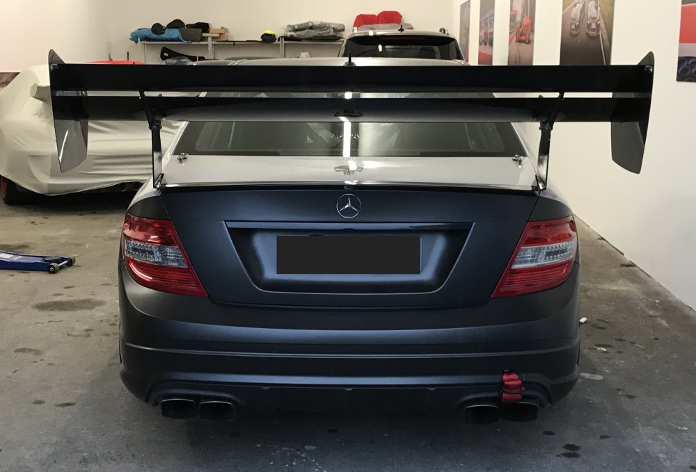

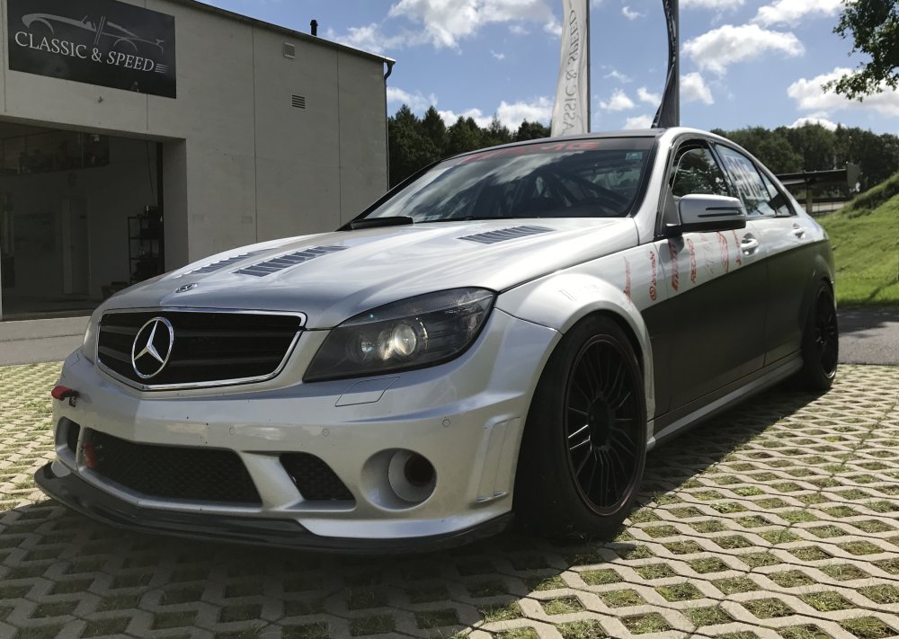

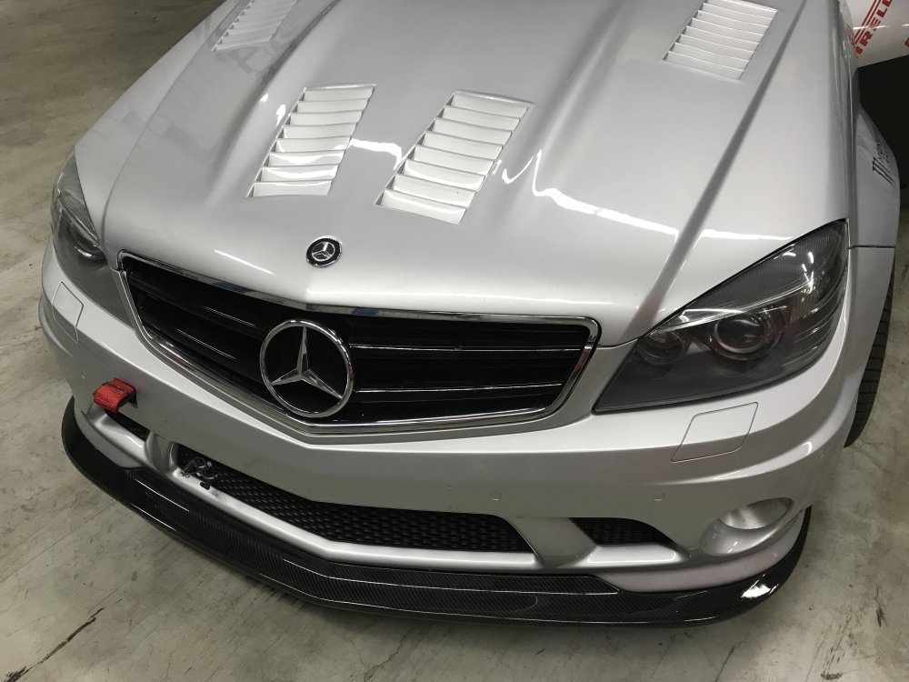

The chassis upgrades are numerous, with the most prominent being a full weld-in roll cage set up. From there, carbon fiber doors, trunk, roof and hood add lightness. Additionally, he has two different aero setups, for road and race. There is a big wing, a front splitter, and rear diffuser element to provide big downforce. However, on the street, that big rear wing is exchanged for gurney flap to keep things subtle.

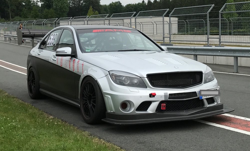

Suspension upgrades include inverted KW Competition coil-over suspension, and upgraded suspension arm bushings. Oh, and an aggressive track-spec alignment with 4.4° of negative camber up front, and 3.7° degrees in the back.
The brake package on the car is equally aggressive. You’re looking at SLS GT3 front brakes, with massive rotors measuring 380-mm in diameter and 36-mm thick. Performance Friction’s “01” brake pad is used (your Editor is a big fan of PFC products on track). The rear brakes are the original caliper and rotor using Pagid RSL1 pads. Castrol SRF brake fluid flows through the calipers and a proper brake ducting setup eliminates issues with boiling over the fluid or cooking the pads or rotors.
Housing those massive stoppers are some pretty serious wheels. They are Motec DTM wheels, which measure 18×10″ +50 in front, and 18×10″ +55 out back. Depending on the event, those wheels are shod in either 265/35R18 Pirelli Trofeo R semi-slicks, or 240/640 Michelin S8L slicks.

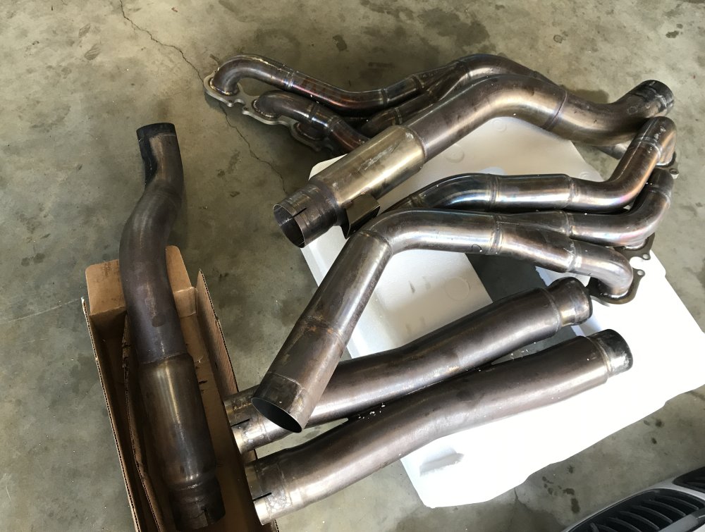

Like many track cars, engine upgrades are limited for the sake of durability. There is an Akrapovic titanium exhaust with 200-cell sport catalytic converters. Additionally a modified air box with aftermarket filters sits in the engine bay. An ECU recalibration with a custom tune is also involved.

This C63 weighs in some 370 kilograms lighter than when it began. That’s over 800 pounds of weight reduction. Good lord. Where do we sign up?

He also switched to a new Remus exhaust system and he made a video showcasing the roar of his Benz with the new pipes.
