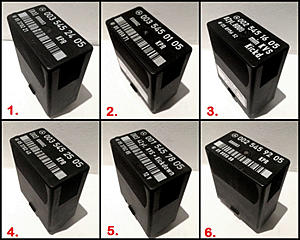

Good Day,
Please help, anyone can give me right part number for my fuel pump relay1984 190E Automatic with VIN WDB2010241F000706
Thanks for the effort

There are "5" #'s of 190E fuel pump relay:-
"001 545 08 05" or "001 545 57 05" or "001 545 78 05" or "002 545 05 05" or "003 545 20 05",,
*see which one capable with yours..
