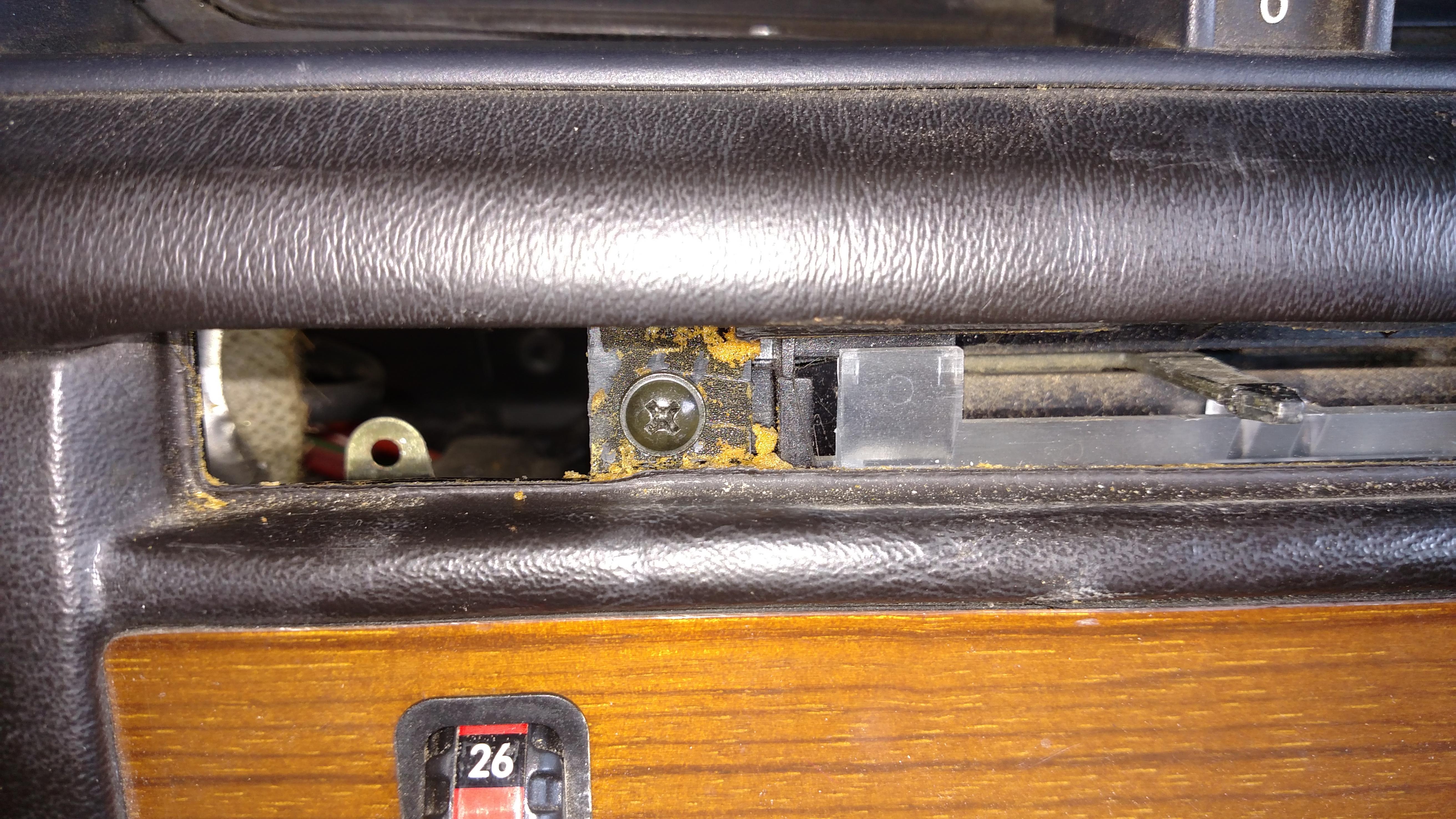

Now I'm trying to remove the AC control unit. It's not as straight forward on certain web sites. On my 88, 2.3 there are no screws under the control panel. Do I have to remove the entire center console? I've attached pictures of what I'm looking at
