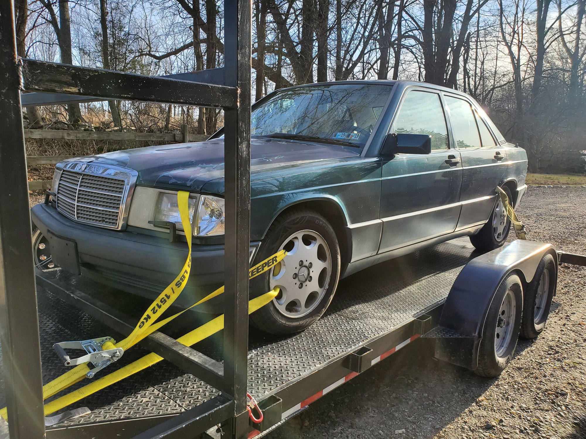

I just told you way to much about myself but I figured it may give some legitimacy to the project I have started. 2 weeks ago I bought a 1993 190e with a solid body.

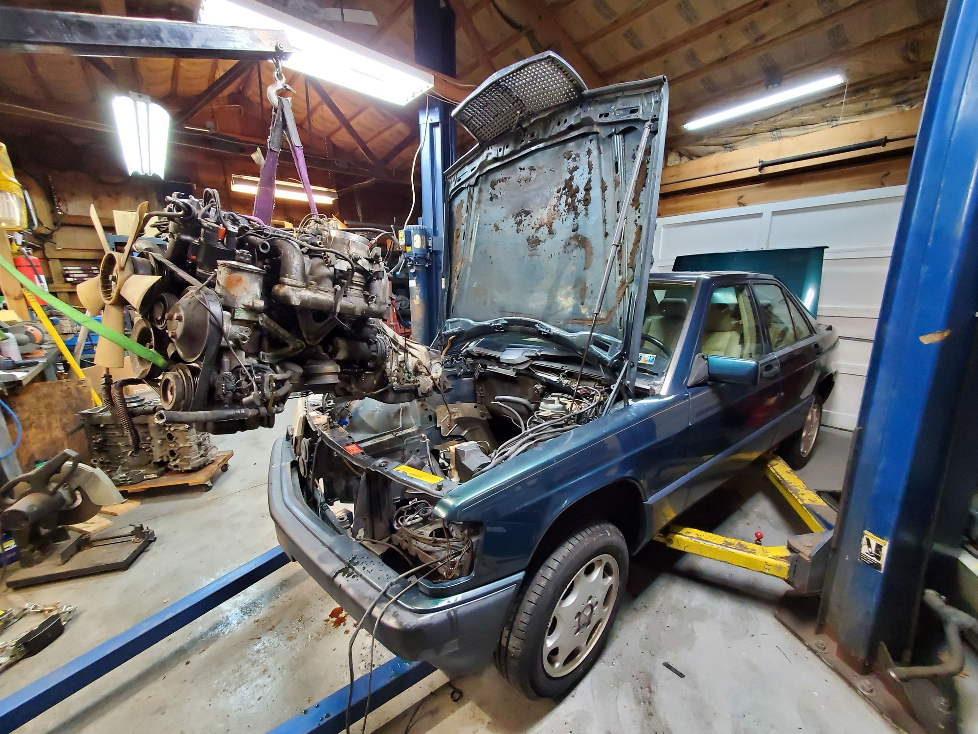

I started on the project today by first pulling the dead 2.3 out of it. I am starting the project at home because I have a lift. Once I get the engine swapped in here, I'll be bringing to the shop to do the cage and various other things.
Yanked the engine out this afternoon. I will mock fit the engine soon so that I can plan out some new mounting and modifications to the crossmember.

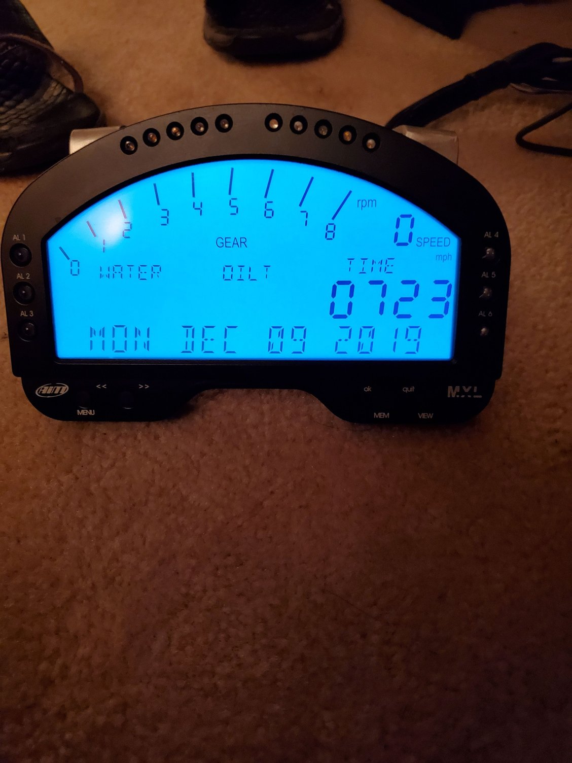

Also got in my fancy dash (aim mxl pista):

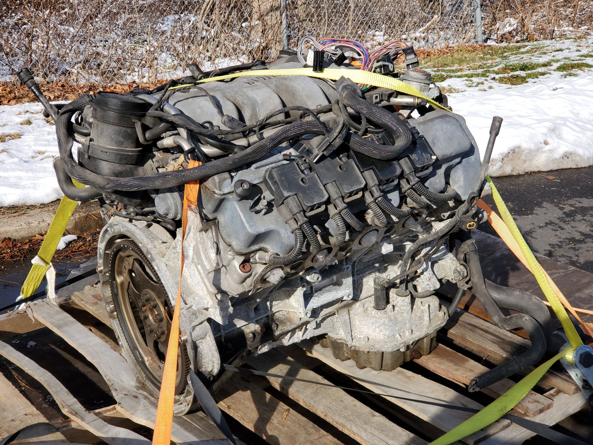

Picked up the M113 yesterday!

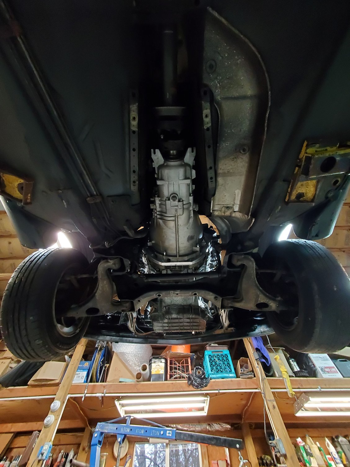

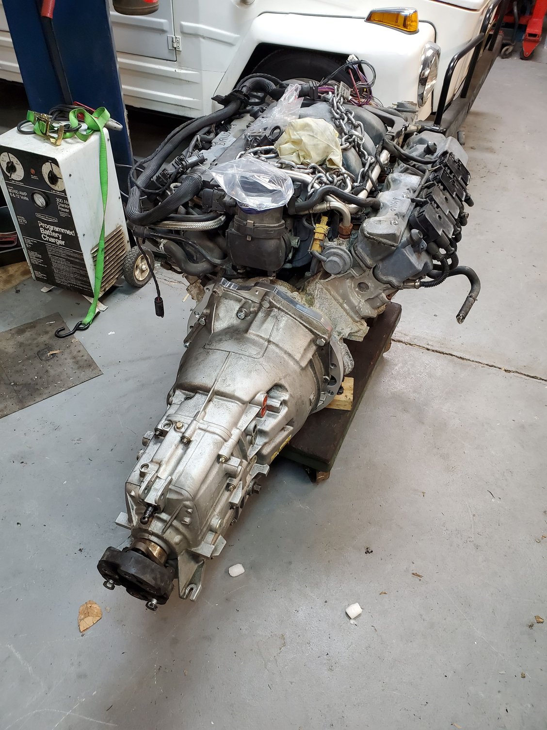

Got a bunch of parts in. Trans adapter and clutch, electric assisted steering, ECU Masters EMU Black, amd wiring harness.
Test fit the engine/trans combo today and I have to say it doesn't look like I'll need to do a ton of modifications to the body for this at all work.
