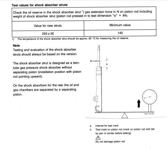

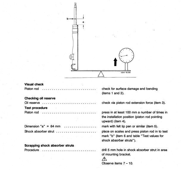

The procedure requires you to remove the struts, but I wouldn't just necessarily replace them, because if you spend the money and replace them and the problem persists, then you're now worse off with less resources to purchase the parts you really need. Unless of course you are just able to replace parts whenever you want to.

There is a layman's (or laywomen's) way of applying Ismalley's test while the struts are in the car.
The way the strut is tested is to measure how much resistance there is to compression and when you let off the compression how quickly does is recover.
You can imagine how the springs and the rest of suspension gets in the way of measuring this with an installed strut.
However, when struts go, they are usually not equally bad. With mine the passenger side was considerably worse than the driver side.
Long story short you can apply equal downward force with your body weight instantaneously and observe how much resistance there is comparatively between the left and right for front and rears. If they are considerably different you know the less resistive one is shot. A new strut will have severe resistance particularly if it is a HD or sports strut. And if they are not equal, like mentioned before they are replaced in pairs.

But there is no baseline for her to compare it against in regards to an unworn suspension. Plus there would be too many variables like weight of the engine, tire pressure, suspension bushings, etc. To be honest, if you are just going to replace the struts without testing, it's best to just do the complete front end. If you get those new struts installed and the car still feels the same you'd probably be tempted to just get rid of it, because at that point you'd only keep guessing at which part is affecting your ride quality until you eventually end up replacing everything anyways 🤷‍♂️. I personally think that spending how ever much time or money to do the job and get your desired outcome is well worth it. Plus, seeing as this is not a daily driver for you, you may have the leisure of not having to have it done all at one go. Just my 2 cents. Good luck.
