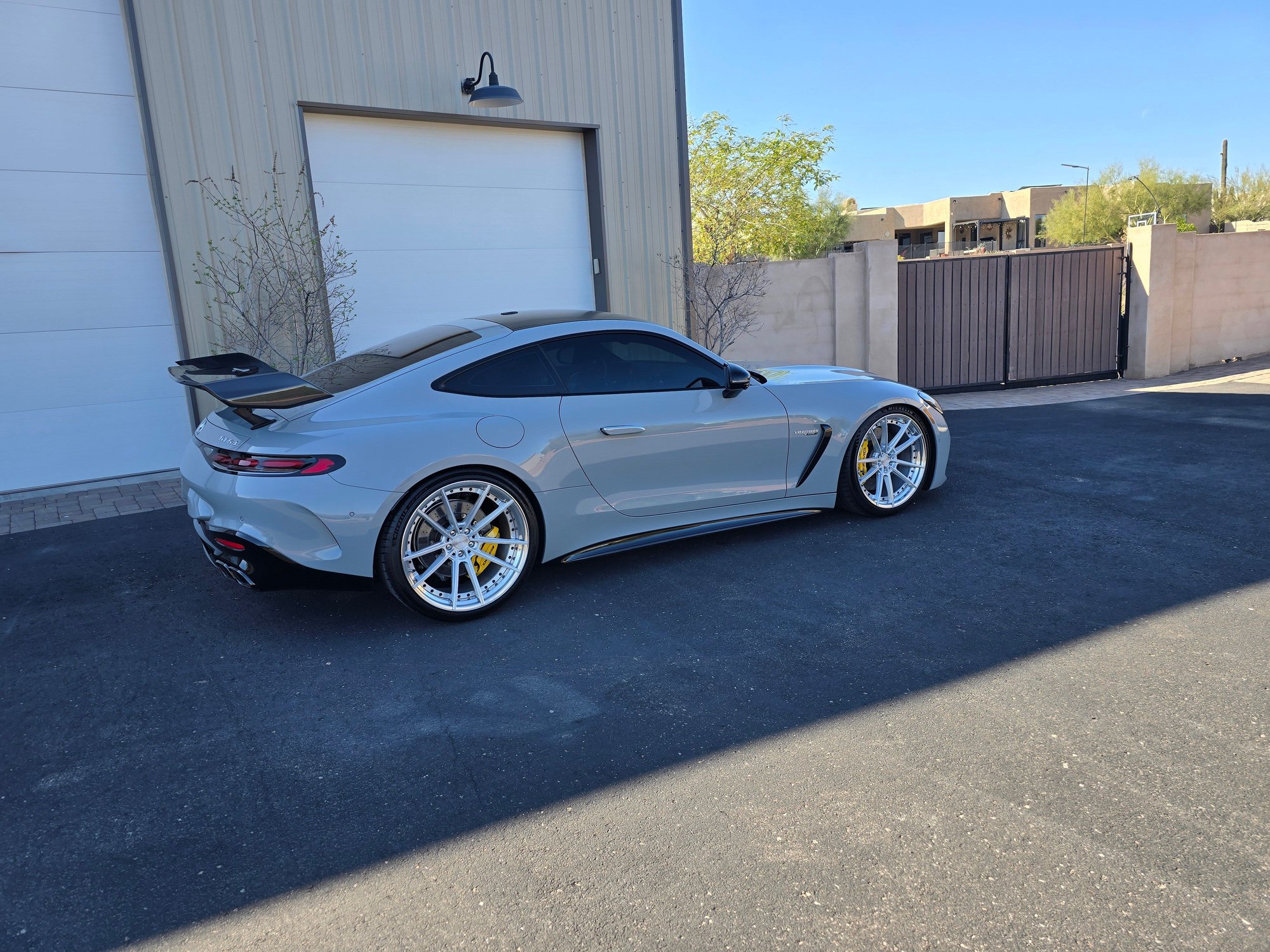

Old Mar 27, 2025 | 12:08 AM
Zmangt63's Avatar
Joined: Oct 2024
Posts: 145
Likes: 20
Old Mar 27, 2025 | 08:47 AM
Vic55's Avatar
Administrator
Joined: Nov 2001
Posts: 12,263
Likes: 901
Looks good ...Thats limited rake for sure.
