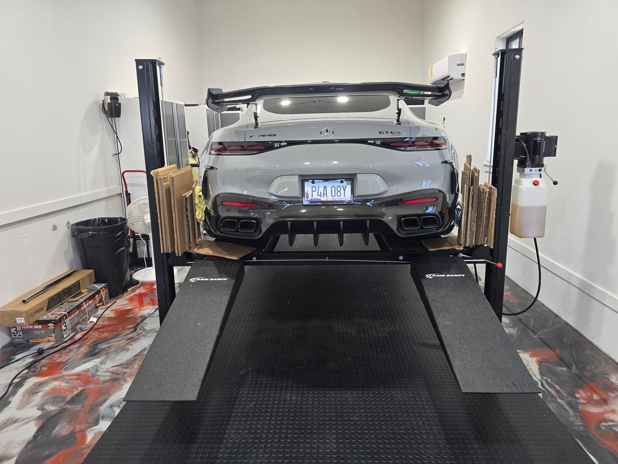

There are a few choices. Yes you have to disable the factory wing. The easiest way is to remove the arms that lift it up. The ecu then thinks all is good because the motor still spins when told but it's not connected to the wing.
I went with darwin pro

Looks great!! Thanks for the input!!
