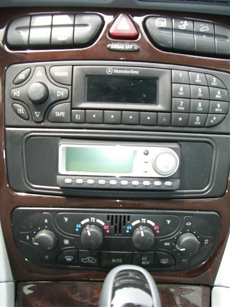

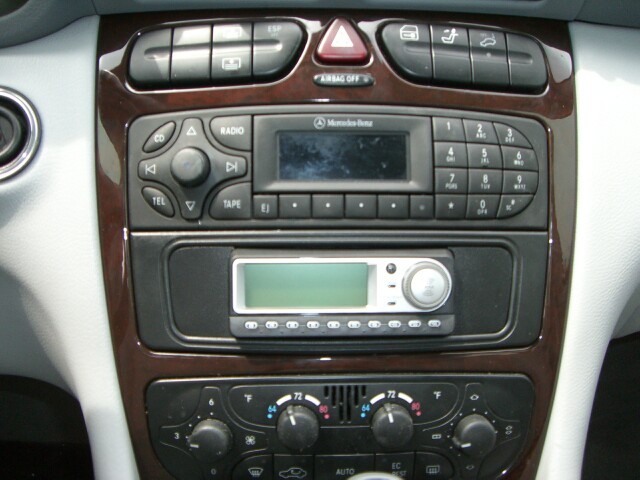

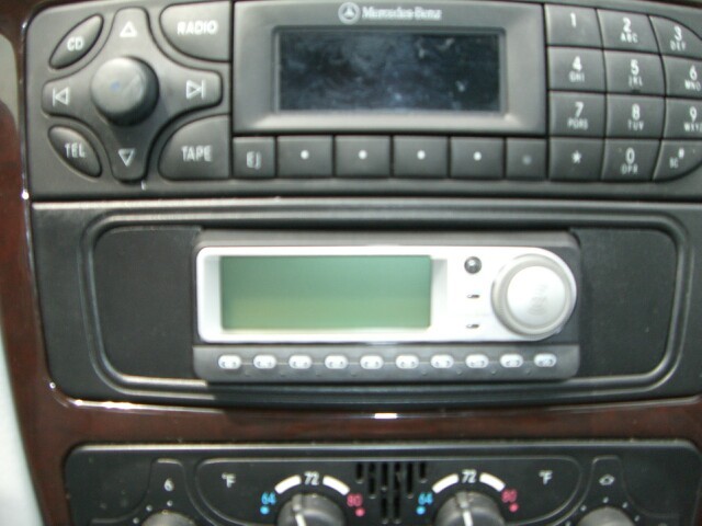

here's this
Attached Thumbnails Power for XM receiver in C240-xm-radio-1.jpg   Power for XM receiver in C240-xmradio-2.jpg   Power for XM receiver in C240-xm-radio-3.jpg

Johnddd...Looks very clean. Where did you go for 12v power?..
