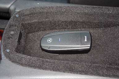

I beleive the iPhone does not support SAP, and the euro SAP cradle therefore can not pair.
So you need the european Bluetooth HFP cradle.
See www.comandonline.co.uk who have stock and are a load cheaper than the local MB dealerships in the UK
Richard

Yup, but I guess you are using the HFP cradle or (small black one, or a ViseeO, rather than the MB SAP one (shiny one).
(Nb. USA has a shiny version of our HFP cradle and no SAP cradle just to cause confusion ..)
