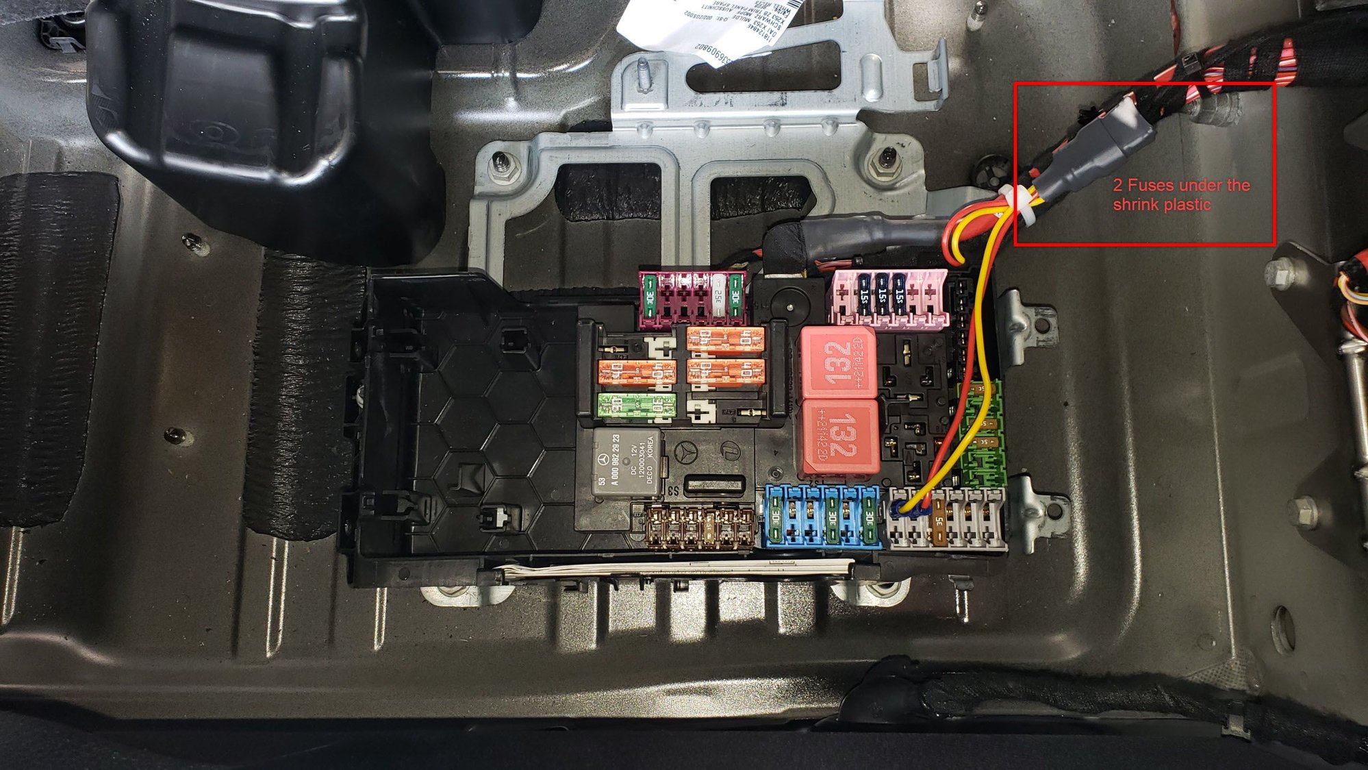

and had it professionally hardwired using the Rexing hardwire kit for this camera. The camera worked great in the C Class, no issues. Now in the GLC whenever I turn on the camera XM cuts completely out.

  • Looked at the ground but I didn’t see one the way they installed it. The fuses are not directly in the fuse box in the trunk, there is a wire coming out of one end of the fuse and into the fuse box. Essentially just extending the fuse. It shouldn’t make a difference. The other end of the fuse goes back to the unit. So it's kind of inline.
Fuse Box ----------| Fuse |--------- Unit

If there's a camera settings option to disable its wi-fi connection, try shutting it off. Satellite radio and wi-fi occupy the same RF spectrum (2.4 Ghz) and the cam's wi-fi could be walking on XM's signal.
