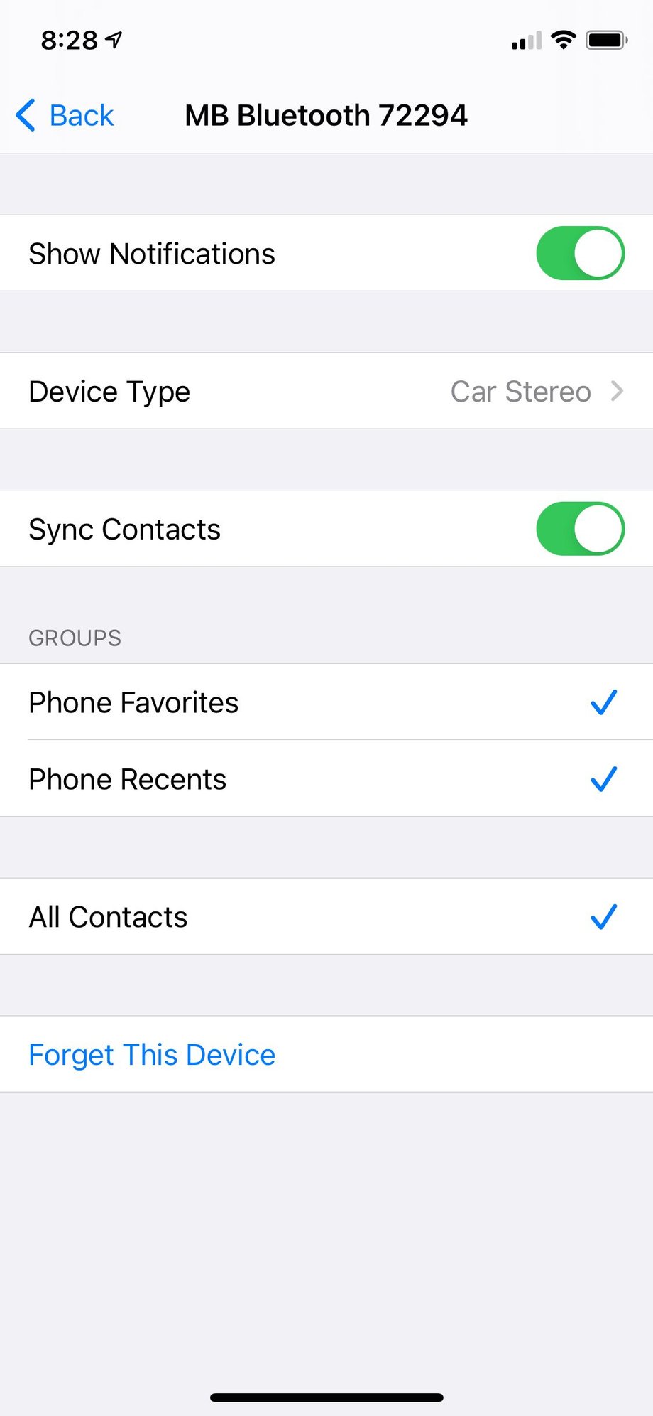

I'm assuming in MBUX you can still manually add a contact which would then only exist in MBUX and not get synced anywhere, but frankly I haven't done that in years in any system. I always sync the contacts from my phone. Well, they sync automatically. Nothing needs to be done. You can't edit a contact in MBUX and sync it back to the phone. That's not how the Bluetooth profile works. The sync is one-way from the phone to the Infotainment system. The information incomplete issue is a bug, and frankly I'm amazed they haven't fixed that in MBUX. I have the same issue with COMAND 5.5 in my '19 C63.
If you are trying to limit the number of contacts that get synced from your phone, then you are looking in the wrong place. That's not something you can control in MBUX. You have to control that on the phone itself and the how depends on what phone you have. But basically under the Bluetooth settings in your phone, you should be able to control whether you wanna sync all the contacts, only favorites or specific groups or none at all. MBUX etc. just takes whatever it receives from the phone.
EDIT: FWIW, here's how the contact management looks like on my iPhone. As you can see I'm syncing all contacts, including favorites and recent. I don't custom group my contacts, but I believe if I did, those groups would show up here as well and I could sync those specific groups if I just wanted a specific subset, or I could just make the contacts I want on my car favorites on my phone and then just sync the favorite contacts.
