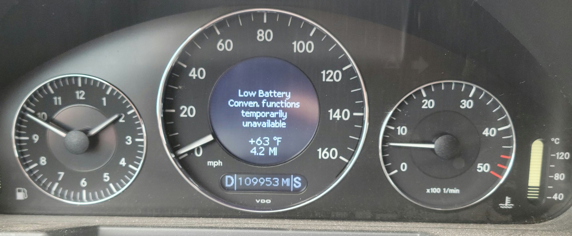

Just bought a 2006 e320 with the 109k miles and drives like a dream. I just changed the oil/filter with Liqui Moly 5w/30 Longtime High Tech, Changed the fuel filter, Transmission filter and Liqui Moly Trans Fluid, front brakes, coolant and power steering flush. I noticed while driving that I would get a intermittent, "low battery convenience functions temporarily unavailable." I changed the Aux battery with an OEM battery and that didn't help. I changed the main battery with an OEM MB battery and that didn't fix it. I believe the previous owner changed the VR, not sure when, with a Bosch VR but obviously that didn't work either. Called a few MB dealerships to price out another VR and they only sell the entire alternator.
Anyone experience the same issues?

Have you had a mechanic do an alternator diagnostic check? Cheaper than continuing to take shots in the dark.
