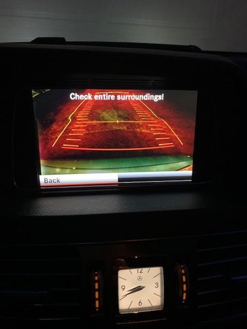

I recently purchased an E350 with the standard stock Command system with Navigation. After owning it for a few weeks I have begun to notice that the rear backup camera screen will display however it will be very dark and the colors are not accurate along with a line that will run across the screen. I can not replicate it however I would say about 50% of the time the screen will display correctly and the other 50% it will be very dark and impossible to see.

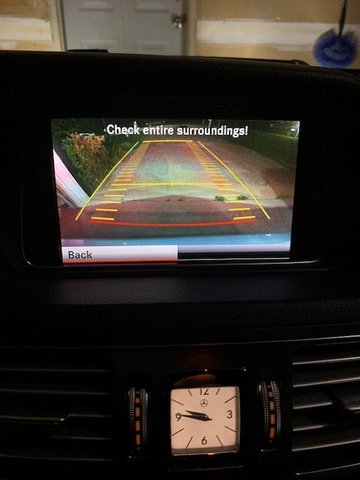

I have attached a screenshot of the camera when it is not displaying correctly. Although this was taken at night at the time I did not have the rear brake lights on and the screen has a red tint. You are also able to see the line I mentioned that tends to run through the screen when this issue happens. I have also included a shot from the same time when the camera was working correctly. I have searched the forum and I wonder if anyone would know the following:
Is this a hardware issue (the command screen is on its way out)?
Is this a camera issue (such as a physical issue with the camera)?
Is this a wiring issue (such as the video cable from the camera to the Command Unit)?

Alright I am starting to believe it is related to a wiring issue. When putting the car in Reverse when it is very warm outside and the camera will be very dark, I went out and wiggled the camera lens and it made things progressively worse. However, I grabbed the writing harness that comes out of the top of the trunk lid and goes back under the boot cover, and when I wiggle that rubber boot the camera video feed cleans up and looks perfect. I am guessing the writing is somehow compromised so I'll start pulling it apart and checking it out.
