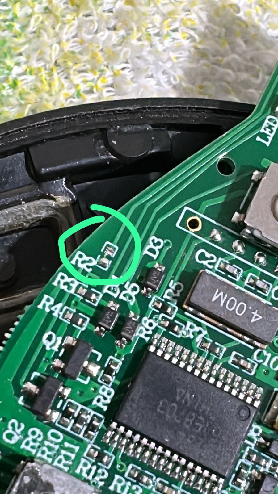

hello! i have a problem with my key fob. a resistor that is conected to the infrared receptor has gone to another dimention. it disappeared (hahah). i do not have another key fob to test the resisteance of that capacitor. can someone measure it for me? it is on a 3 buttom key that uses one single battery and has two chrome sides... on the picture i provided it is marked as "R2". i have found pictures on the internet in which the r2 doesnt go to the Infrared deceptor (marked as RX1 on mine). thaanks!!!

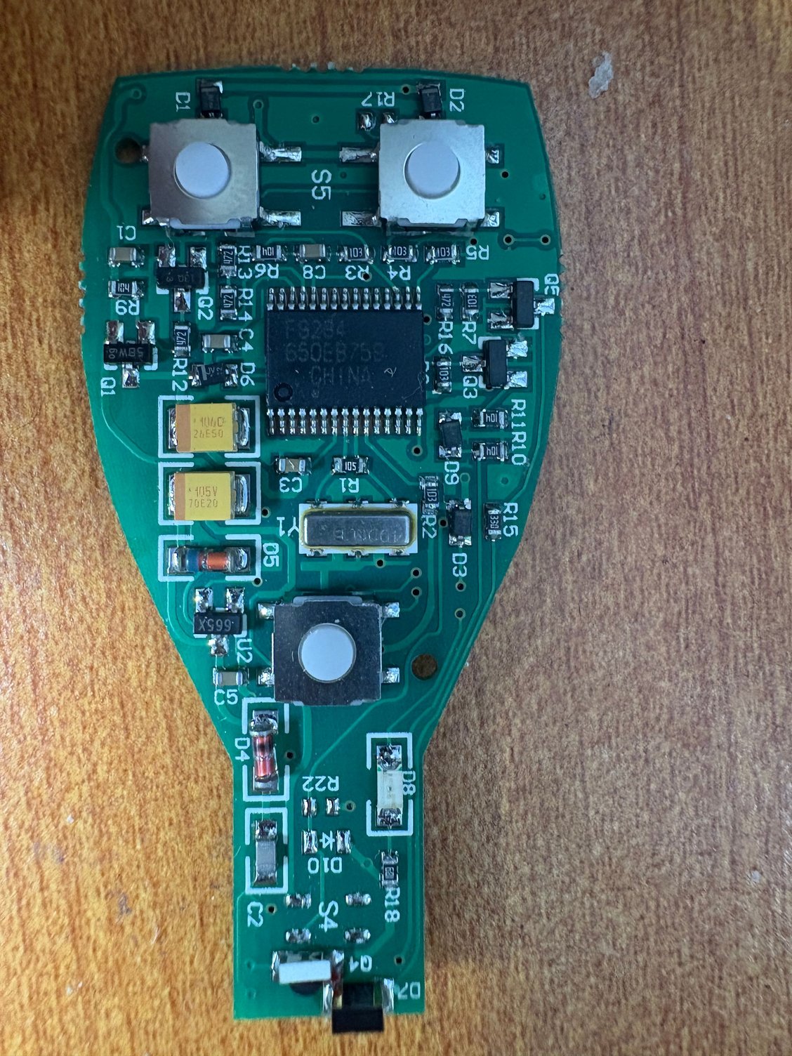

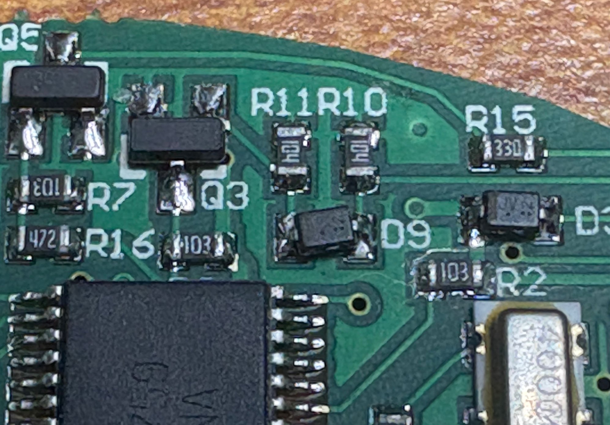

Hi, I have a SIMILAR key. I believe these are aftermarket boards that use NEC chip.
See if these marked components help.
