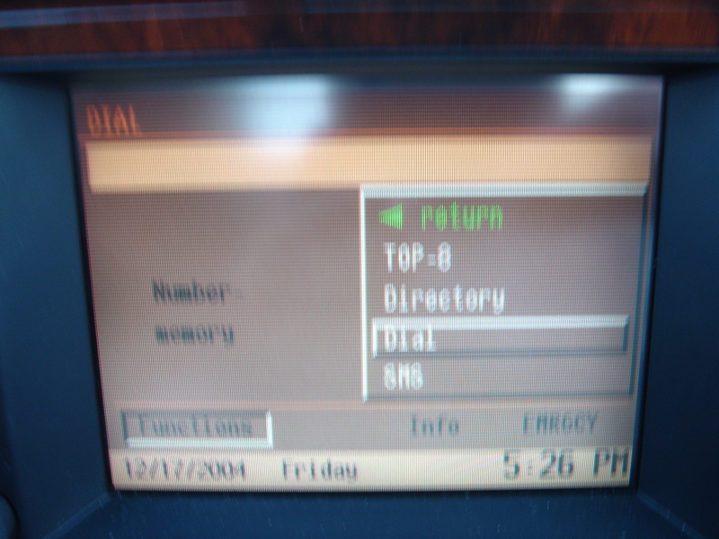

Originally Posted by awiner
Sounds like a great option. Would be better if it is integrated into COMAND (May be for 2006+ models) so you can choose playlists, artists, albmums, etc. via COMAND.
But it seems to be at least integrated into the multifunctional steering wheel according to the little blurb they have:
Attached Thumbnails Mercedes iPod speculation: Q&A-ipod.jpg

Right T... You can use your MFD it looks like... But can't use COMAND to do it

LOL! Yes, you are right! It's interesting that BMW seems to have a slightly different take on things. They have a lot more "retrofit" kits available and since their systems seem to be more common across the cars (pre i-Drive), there are a lot more people who figure out how to retrofit various items. I just successfully retrofitted a brand new Bluetooth module into my '97 540i with Mark I (currently they are on Mark IV) navigation! Sorry for the blurry pic but you can even read SMS messages off the phone via Bluetooth in a 8 year old car!
Jeff
