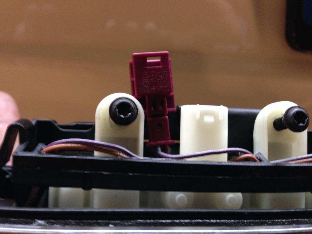

Just unsrew the 4 torx screws
removed on the picture

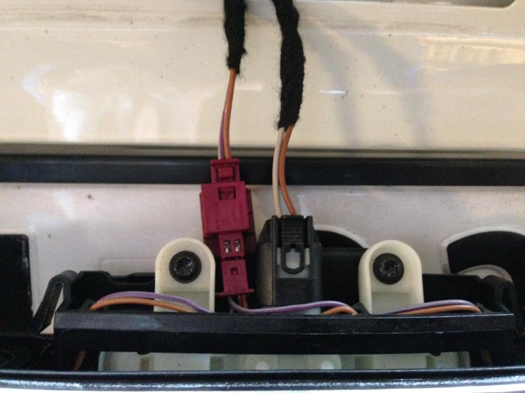

Gently pull the whole chrome towards you and 2 plugs will appear

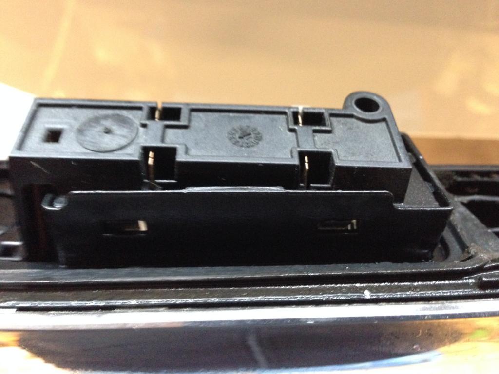

Remove the plugs and the whole bit can be removed

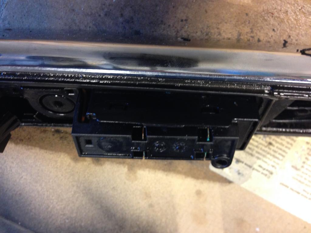

Then loosen the four clips on each lights and pull towards you and the bulb should be reveald, replace the bulbs and mount in opposite directions
I did not remove the glass
