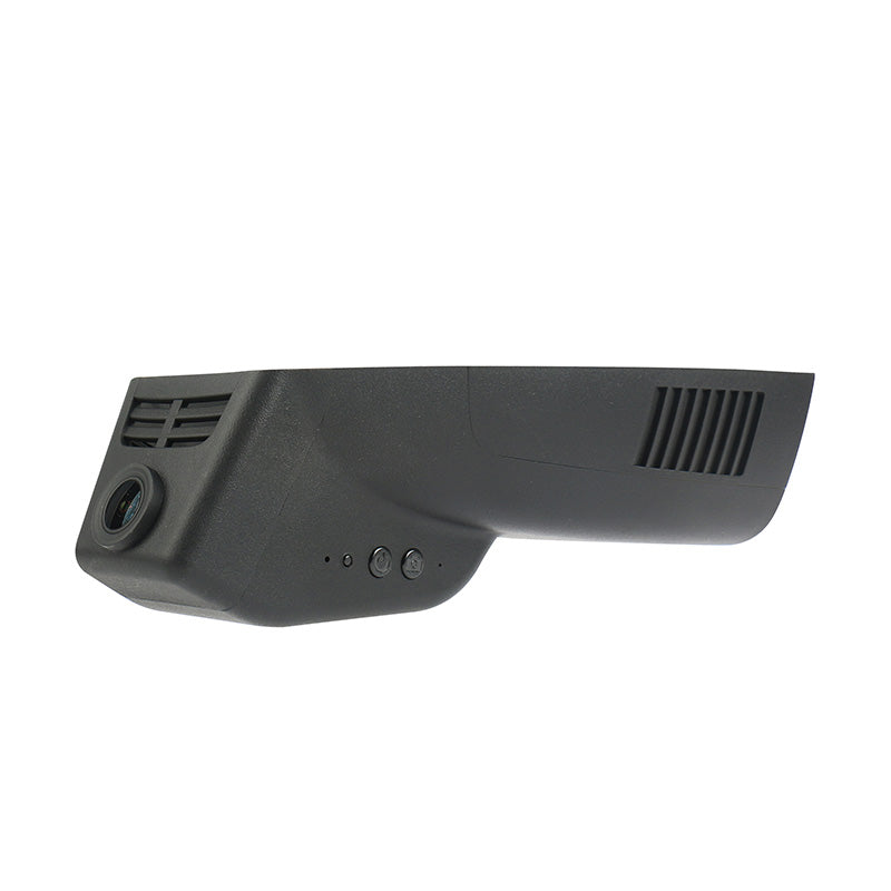

I installed a dash cam that looks OEM and replaces the housing around the rain sensor with a housing that has the dash cam built in. It isn't working, and I want to rule out the power source as the culprit. Not knowing which wire does what in the harness, I'm hesitant to just start probing it with a multimeter. I'm assuming there is a fuse of some sort for the power source located in that housing but have been unable to find a burnt fuse.

Did you figure out the issue? I recently bought and tried to install a similar dashcam and lost power to it as well.

Turns out the connector on the camera for plug and play was wired wrong. The positive and negative were reversed. Once I flipped them it worked.

I got it from Mercylion. It really looks OEM.
https://mercylion.com/collections/fo...m-for-mercedes
