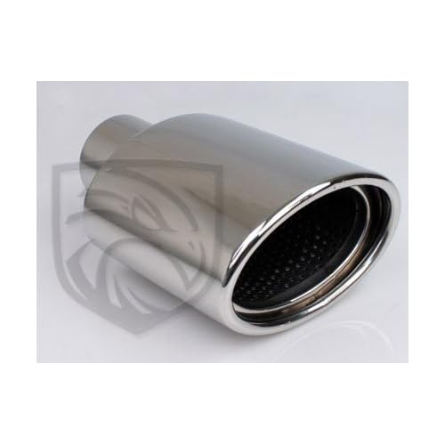

Almost done with the c350 look. I will be completed by early next week. I was too busy to get the install done with work travel and stuff. Anyway collision shop friend a while back had ordered me the wrong bumper trim which was for the pre 2012 w204 (trim is different). I recently returned it and have the new bumper trim and a set of tips that look like the w204 c350/c300 tips except they are resonated (to keep the sound down).
http://ecx.images-amazon.com/images/...xL._SS500_.jpg
I am going with a 1-in-2 out muffler with straight pipes to the resonated exhaust tips. I will start a new thread next week with the complete install with sound.
