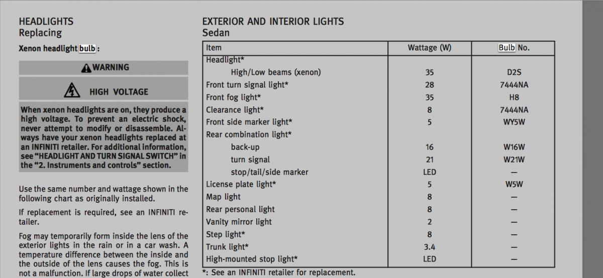

Where can I find the bulbs sizes for all the bulbs inside the car? I want to change the footwell, dome, rear dome, side marker, license plate, and reverse.
This is found in the g37 owners manual. Does Mercedes have something like this?
Also, The car has xenon headlights (lightening package), so does it have a bulb aswell? In my G37 that also had HID xenon headlights which had a bulb which I CHANGED from 4200k to 5300k and it made it look SUPER white and stronger aswell. I kinda like it like that. Is there any way to change that?
THIS IS WHAT THE HEADLIGHT BULB FOR THE G37 LOOKED LIKE
Attachment 276550

Alrighty....I have figured it out!
If you want to change the output on the headlight that HAS lighting package, you need D1S bulbs. I suggest getting 6000k because they are like HYPER white with a tiny blue hue and they look gorgeous.
For footwell, I read this on the bulb 12v5w w5w, so i purchased that type of bulb in red and now my footwell is red and it looks ****ing gorgeous.....matches my seats!
