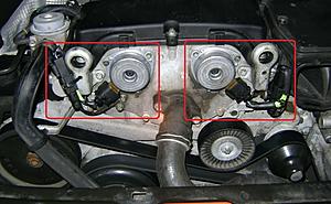

hi is there anyone out there that can help I have a Mercedes c230 1.8 Kompressor 2002 and I have been told to watch the cam shaft sensor as they leak and the oil goes through the wireing harness into the ecu but I have been told you can buy a extention cable for the sensor to stop the oil if it does leak but I need a part number for my Mercedes garage as they said its not on there system if anybody can help with the part number or tell me where I can purchase the cables in uk it would be a good help

You're in the wrong section but this is what you want:
https://mbworld.org/forums/c-class-w...nsor-leak.html
Post #17 from Glyn shows them installed.
Campaign # 2009100001
Cam Solenoid recall
271-051-01-77 Magnet
271-051-00-32 Closing Cover
271-050-27-33 electrical w(ire?)
