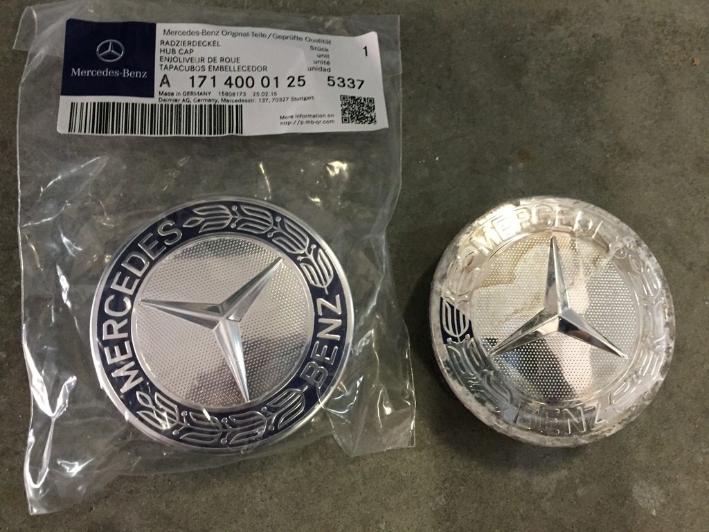

I noticed that one of my wheel caps had fallen apart. So here is a simple DIY on how to change your center cap.
Tools needed: 1. Knife
2. Center cap (Part# A 171 400 01 25 5337) for 2010 E550. (your center cap may vary)
DIY: How to change center wheel caps!-img_9242_zpsf9oh5d2y.jpg

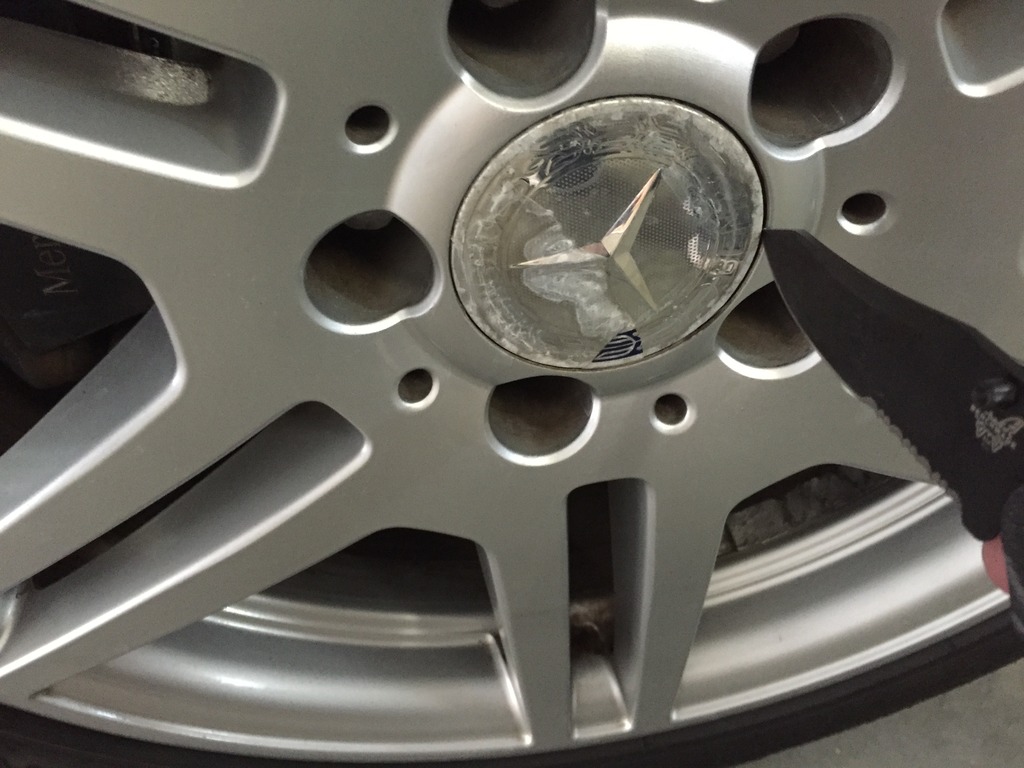

Take your knife and pull off the center cap.
DIY: How to change center wheel caps!-img_9240_zpsb5na0tmh.jpg
As you can see in the picture, the new center cap needs to be pressed in.

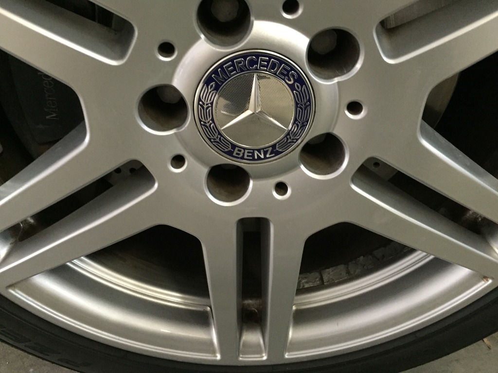

Press in until it's completely inserted.
DIY: How to change center wheel caps!-img_9245_zps1pwni3en.jpg
Done!
