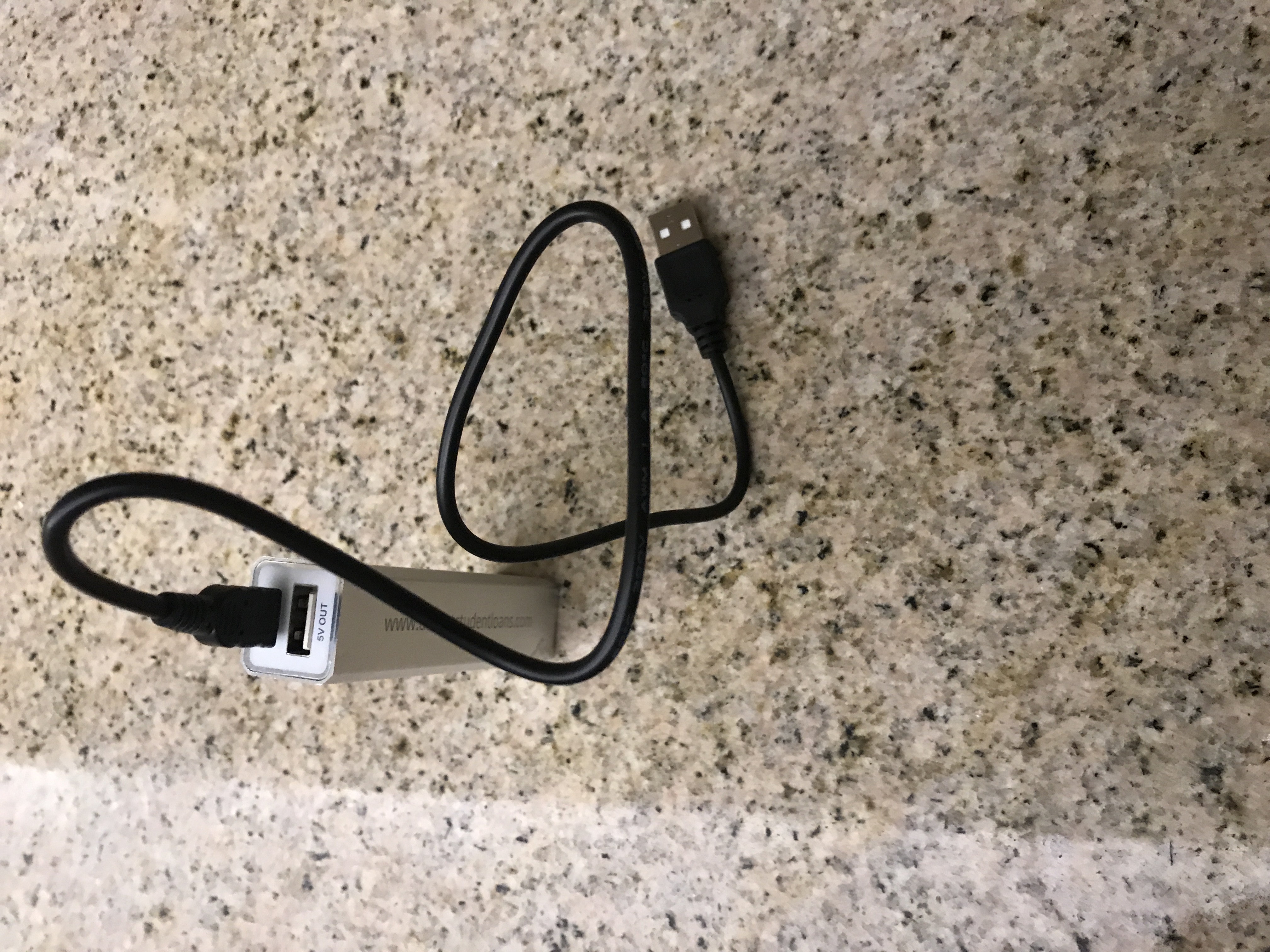

UPDATE
8-25-2017
The media interface is working well with the cable adapter as described above, HOWEVER, the phone doesn't charge as quickly as desired. My iPhone 7 Plus indicates it is charging with the audible sound when you plug it in (but no Lightening Bolt icon.) After driving for a 1/2 hour with dedicated charging (no bluetooth streaming or phone calls) a slight improvement in charge was noted. Same dynamic mic with the provided USB port in the arm rest console. Likely reason is too little available amperes. The owners manual states the armrest USB port provides 0.5 amperes. One can assume the media interface also provides a maximum of 0.5 Amperes as well. Below is a reply on the Apple support forum regarding an iPhone 6 not charging . . .
The iPhone 6 requires more power than either the iPhone 4s or 5. The USB ports in your car may simply not be providing enough power to charge it.
The iPhone 4s and 5 require only a fraction of what the 5w charger they ship with provides. The iPhone 6 requires every bit of power provided by the charger.
So it is possible the vehicle doesn't provide enough amps to charge the phone quickly, however, I may have come up with a solution. I have a small external battery, 4 inches X 3/4 inch X 3/4 inch. I also have a short USB charging cable for that battery. I am leaving that battery connected to the USB port in the arm rest and have a regular length Apple Lightening Cable plugged into the battery. So as I drive the battery remains charged, but when I hook up the phone, it charges faster using the battery.
