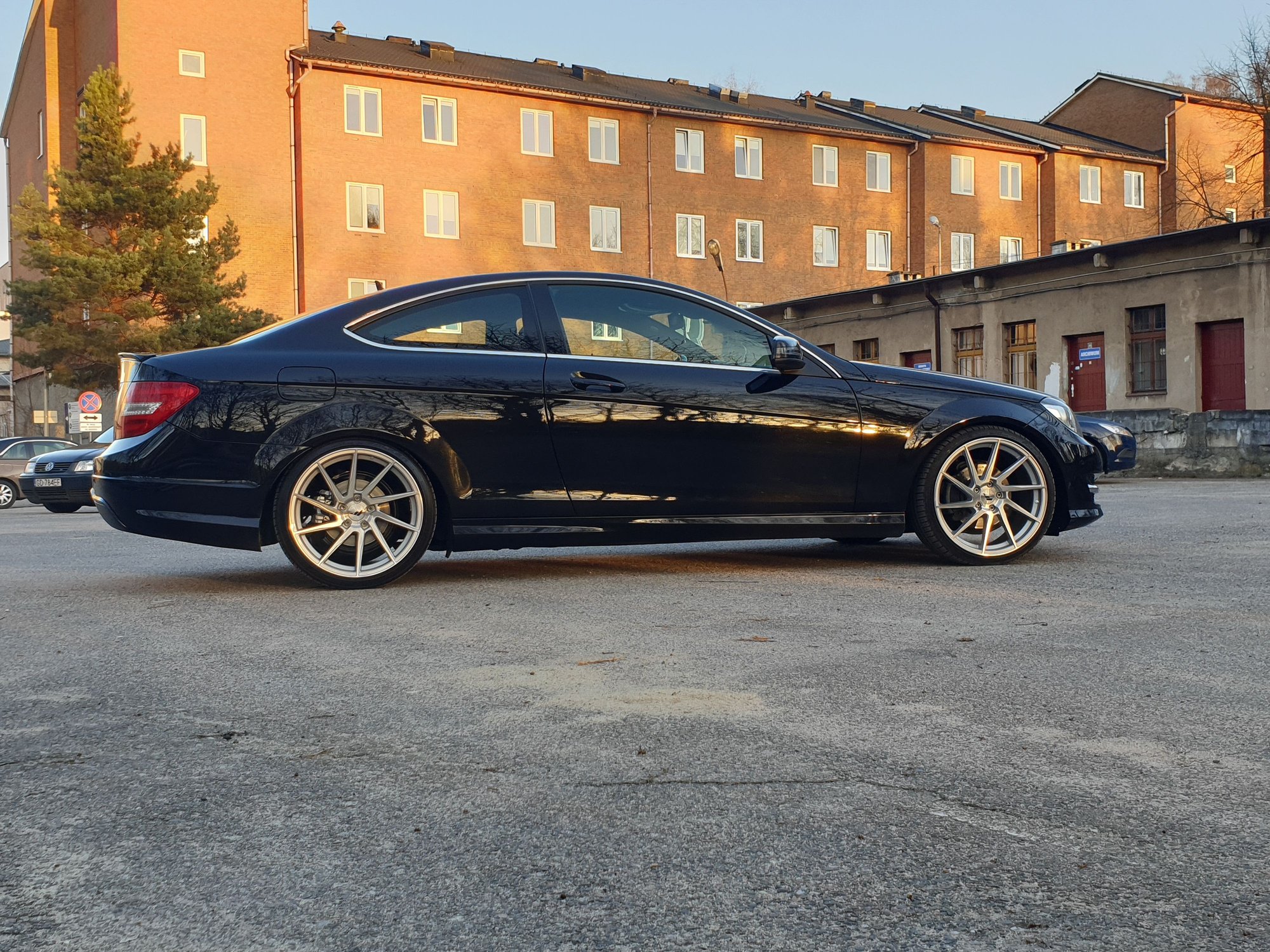

Old Apr 3, 2021 | 03:49 AM
Michał Pranga's Avatar
Joined: Apr 2020
w204 Coupe
Rims: Japan Racing 19"
​​​​Front: 8.5 j ET 45 - 225/35
Rear: 9.5 j ET 45 - 235/30
Springs: H&R Super Sport - 29075-1 (40-45 mm)
