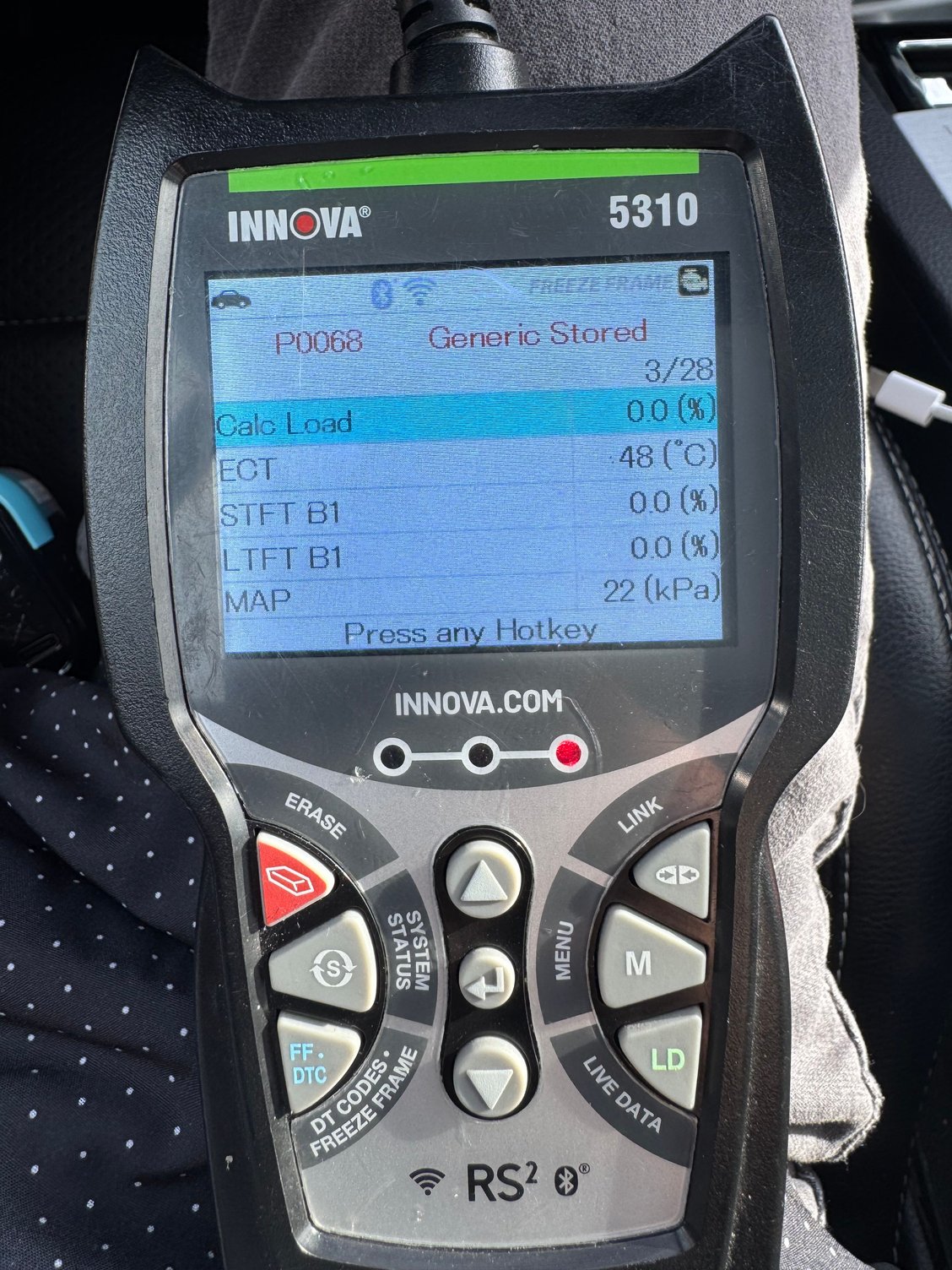

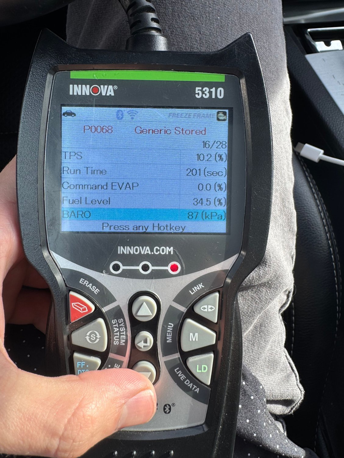

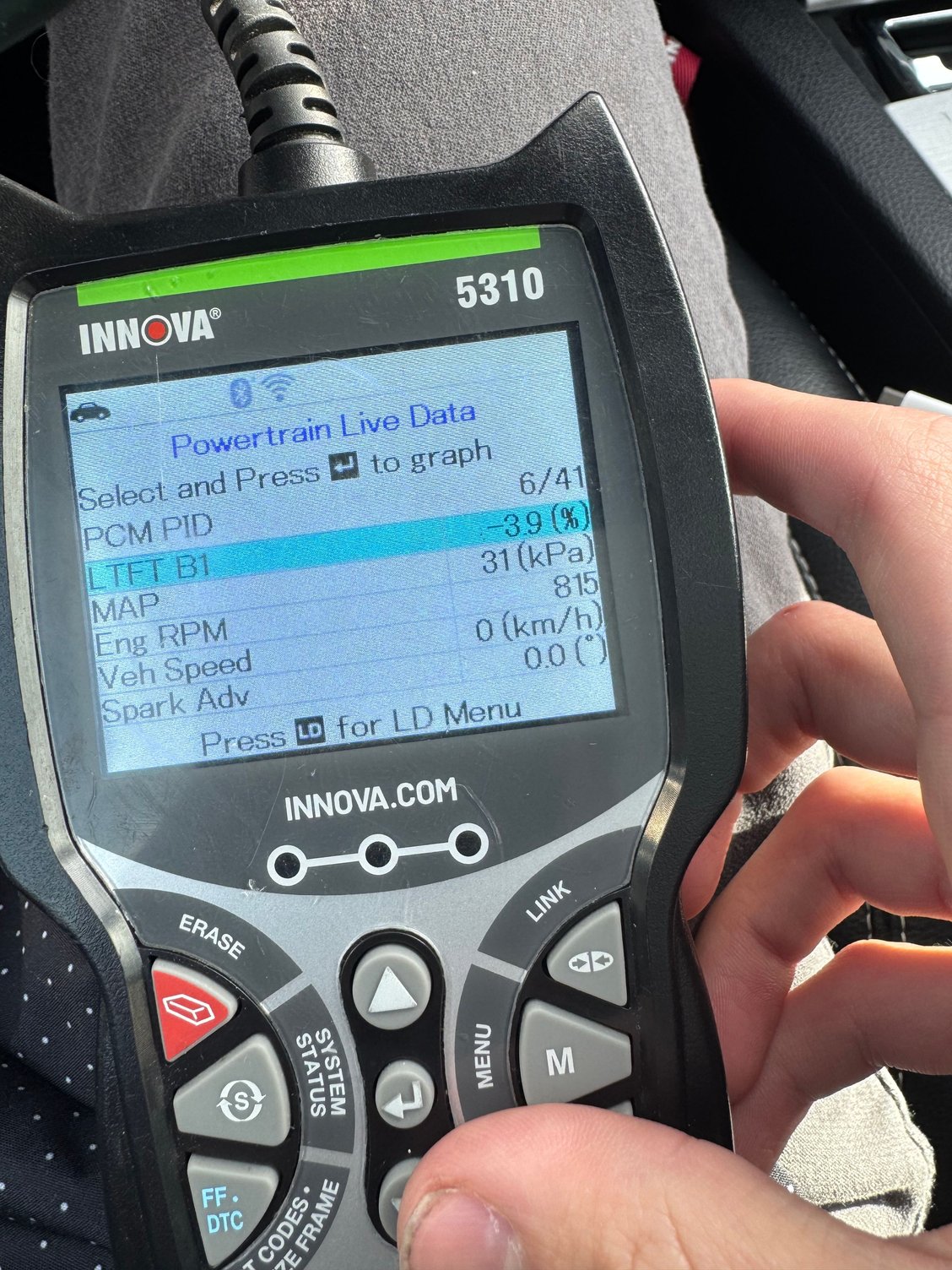

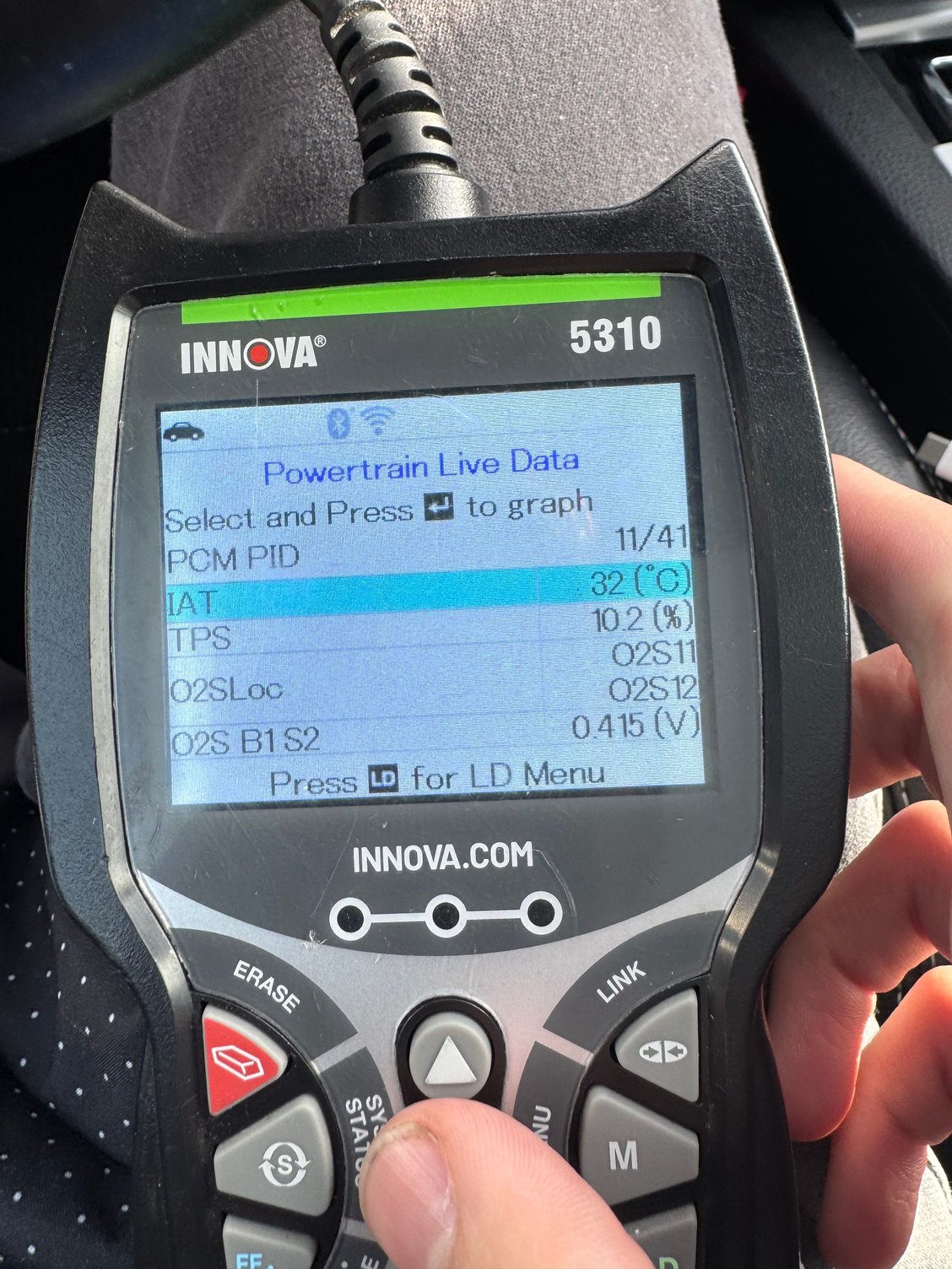

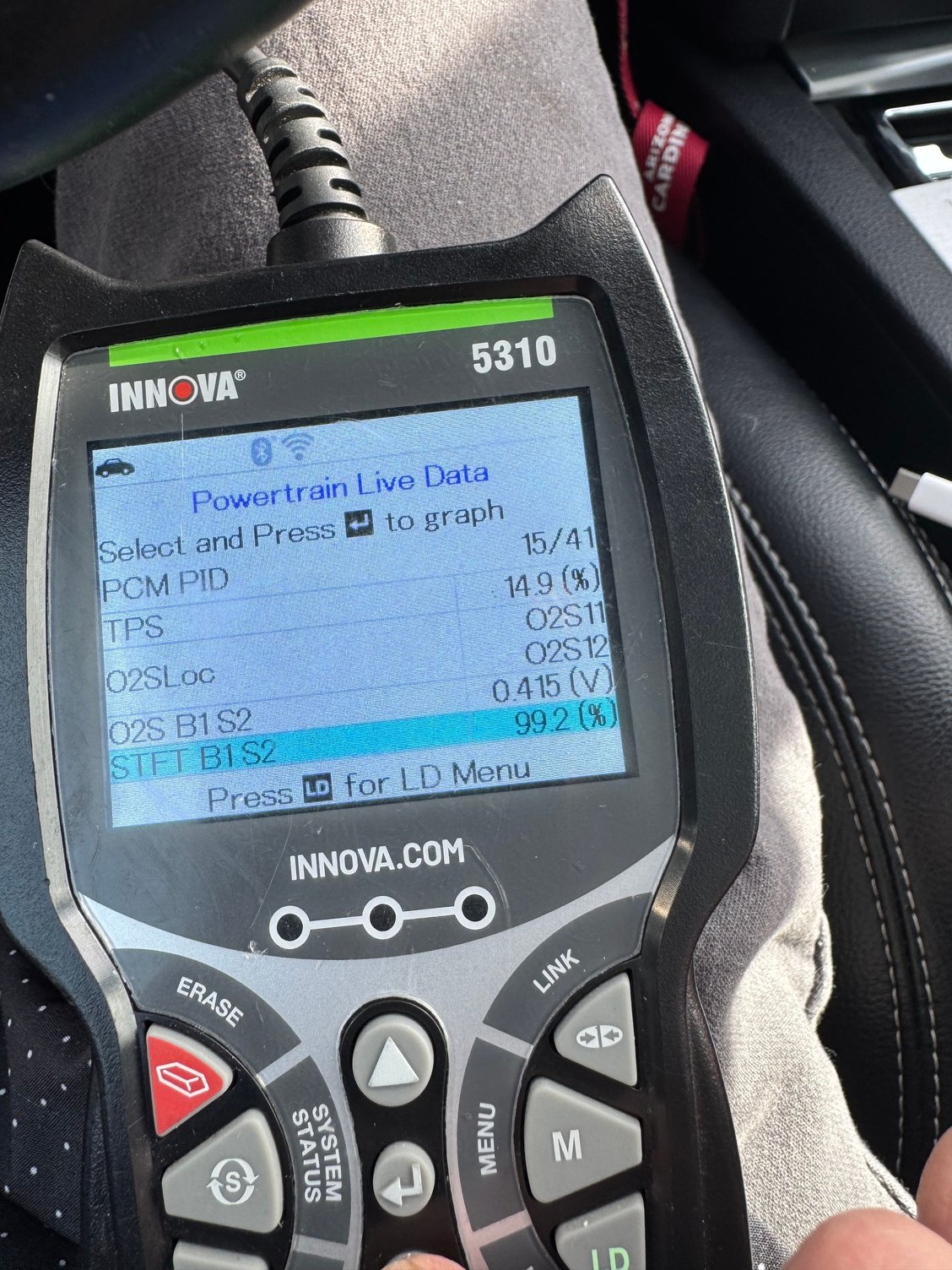

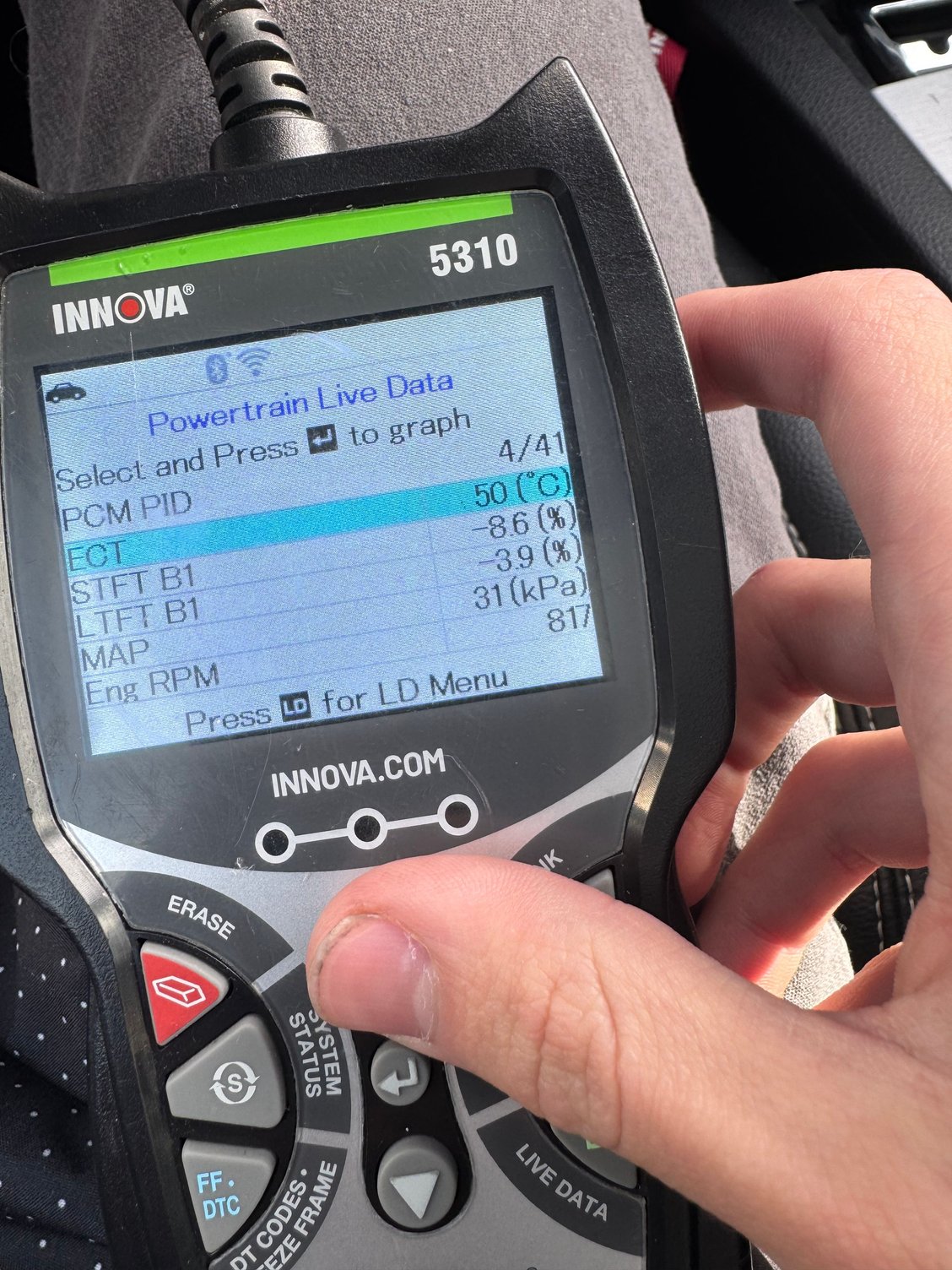

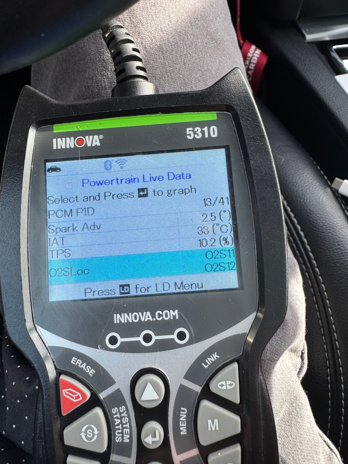

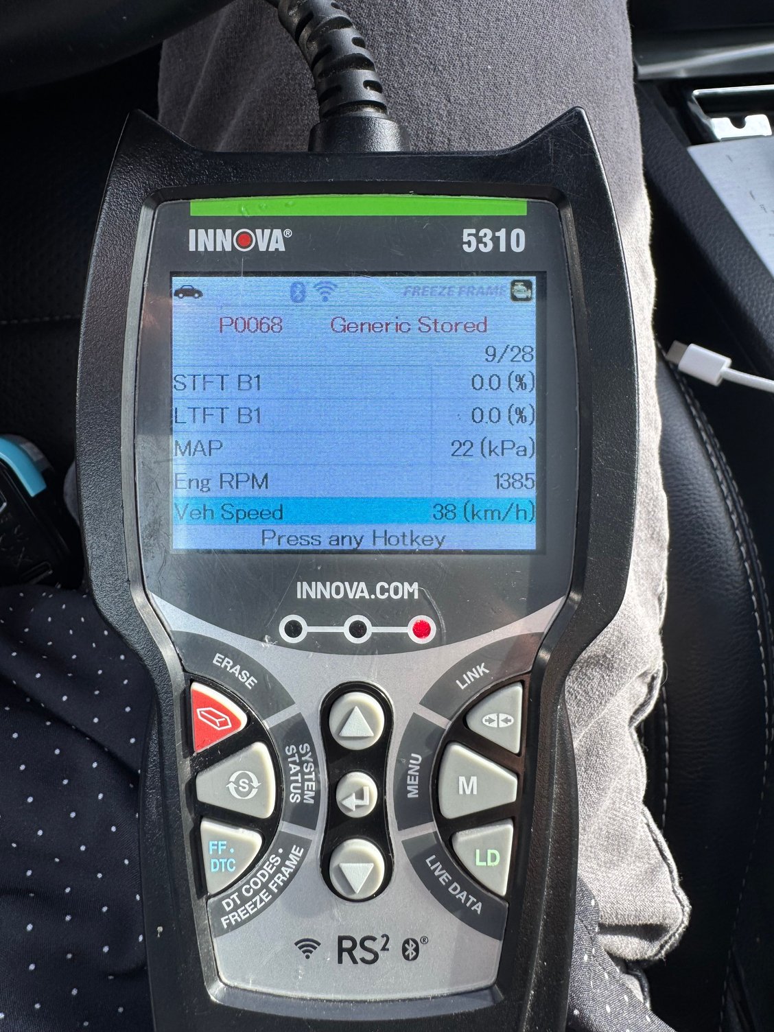

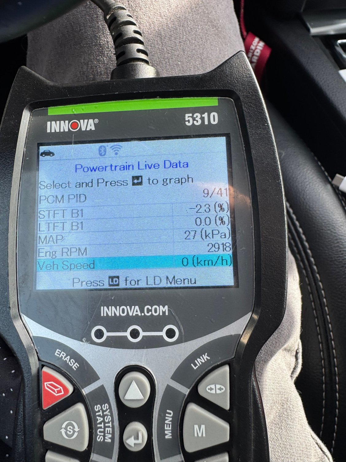

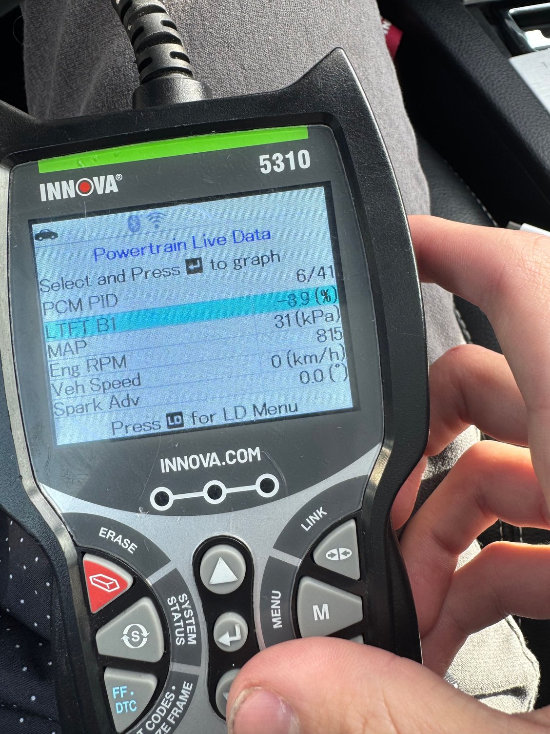

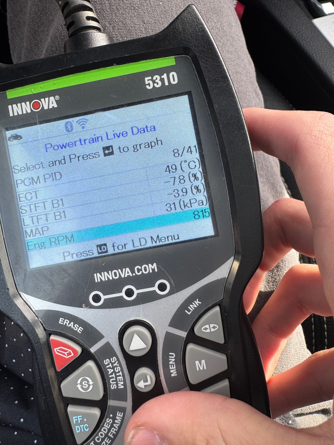

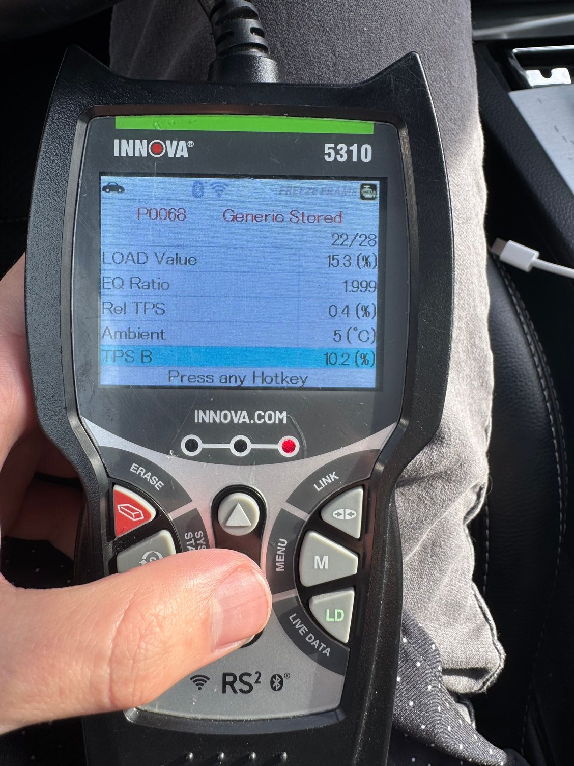

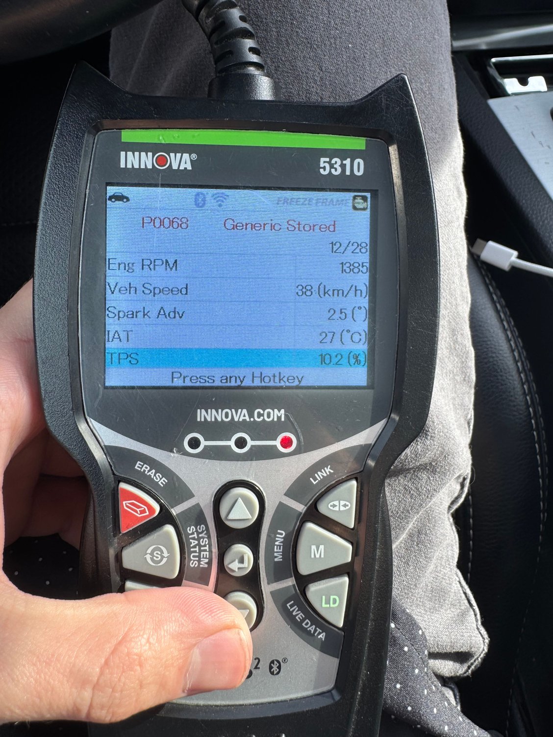

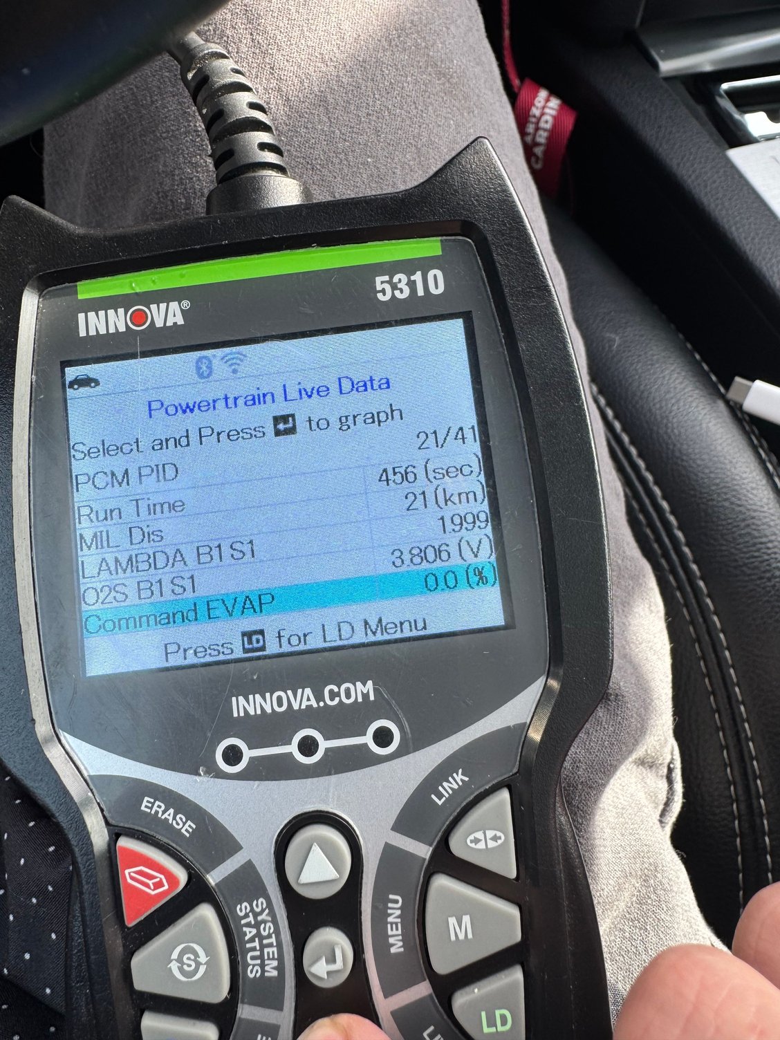

Just got my new to me 2012 c250 but it has this P0068 MAP/Throttle correlation code that has been consuming me. I cleaned the throttle body which wasn’t really dirty along with the map sensor. And did some looking into my scanner data at idle AND at holding around 3000 rpms,does any of this stand out as to what could be the issue? For BARO/MAP reading purposes i’m 4400 ft above sea level. I’m not really noticing any symptoms other than its reluctance to speed up from 0 to like 25 mph other than that it drives and sounds fine. Not noticing any leaks either. Any help would be appreciated because i can’t seem to find the issue and im not real good with reading the data hence why i attached the photos. Thanks.

For reference here is the info from the freeze frame data
