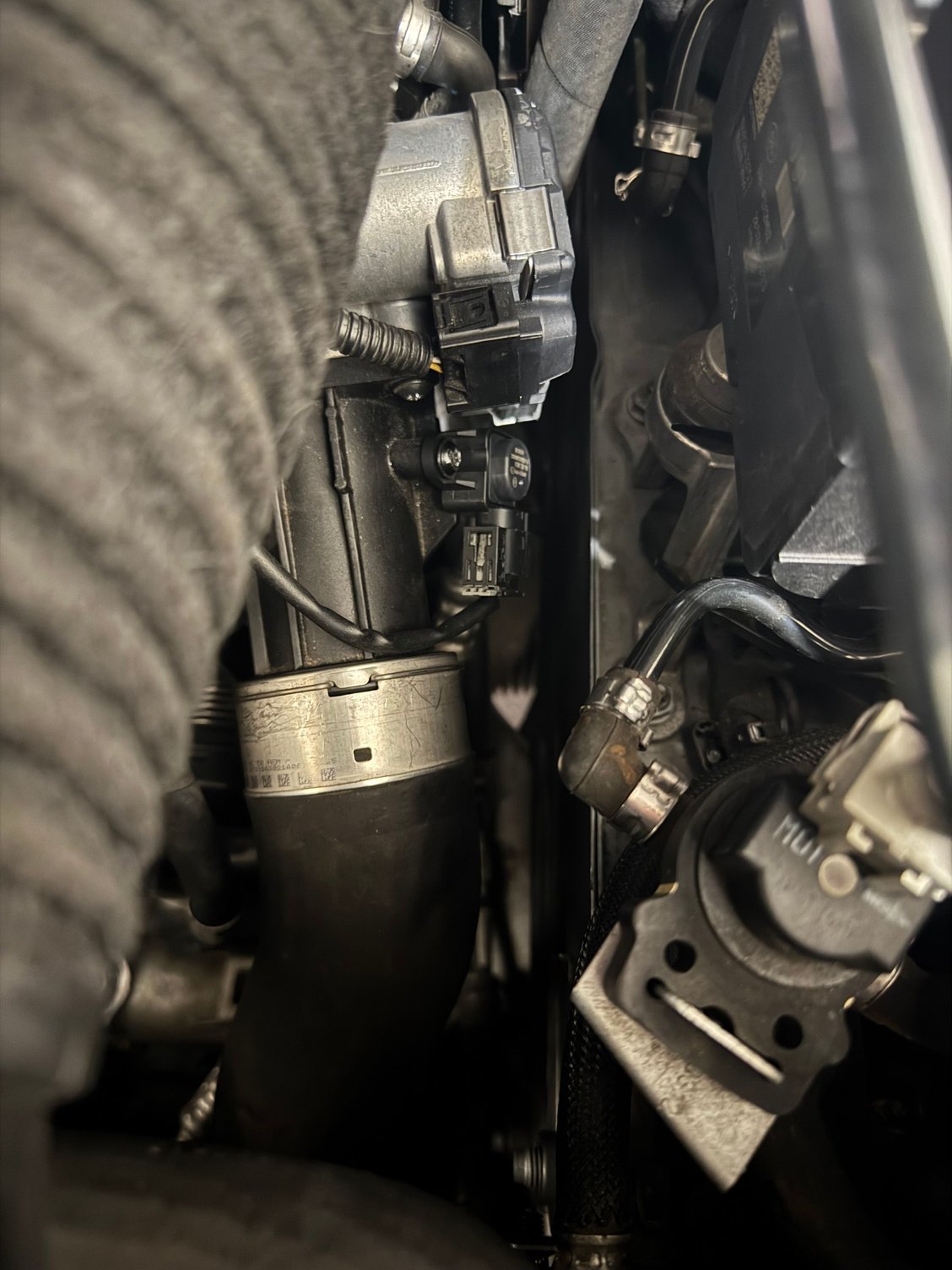

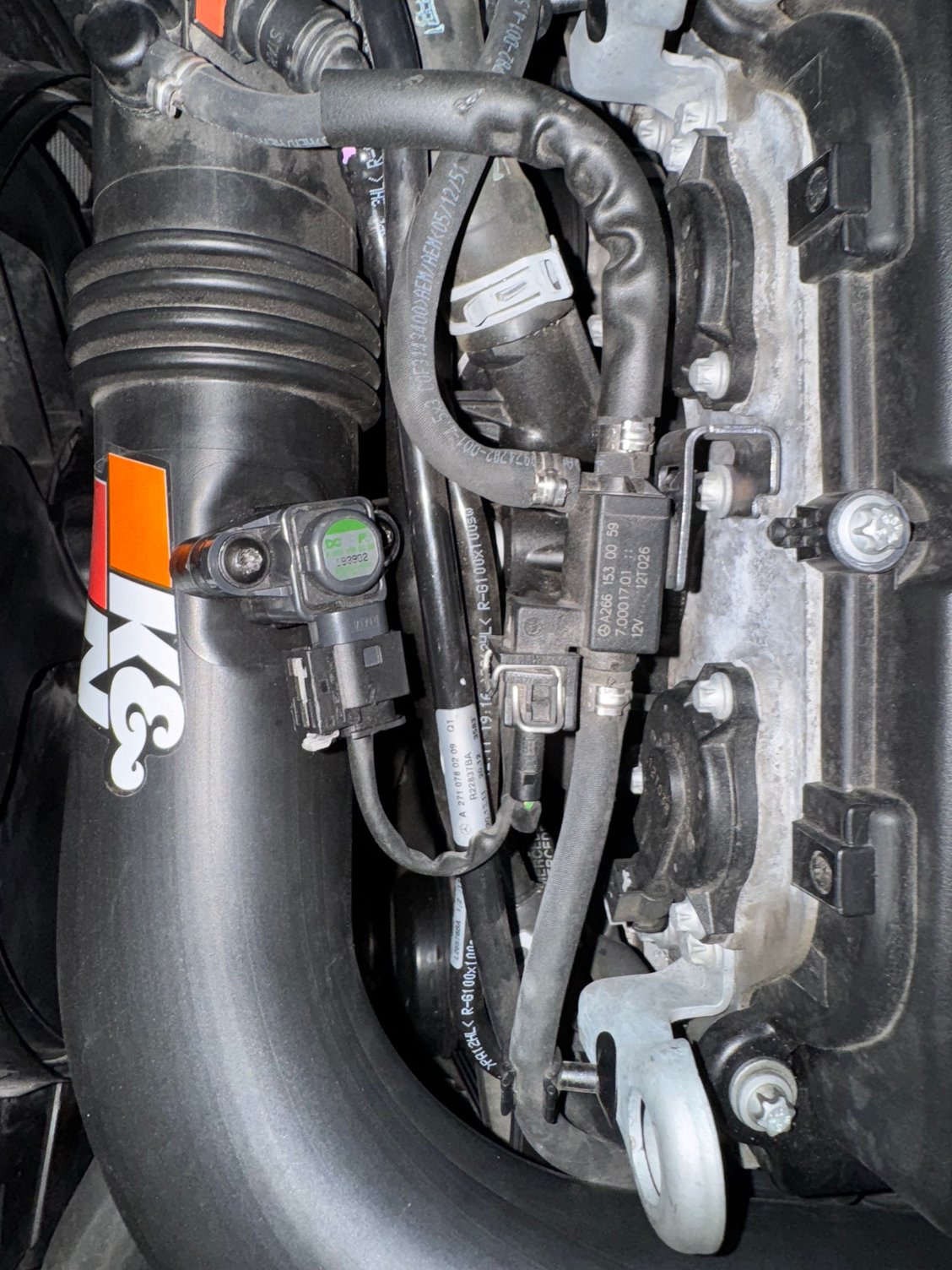

2012 c250, m271 engine. Originally had a p0068 code for map/maf throttle correlation,changed the throttle body,changed the map sensor (to my understanding is the map by the throttle body pictured below) after changing it last night, p0068 disappears and now i have a p0234 and p0236 code. So Im not sure if the sensor i replaced last night was the correct map, If the map i just bought may be bad,or now it's just moved to the map up top because again,to my understanding on this engine,the map on the top, pictured right up top, is the "boost" sensor. So does this mean I had a bad map but my boost pressure sensor is ALSO bad? Any help would be appreciated as this problem has been plaguing me for over a month now. Also as a note, I have checked for leaks in the possible places. Don’t see any cracked hoses or anything. I have put the original map back on as with the new one it went into limp mode with those boost codes so i’m back to being stuck with P0068
