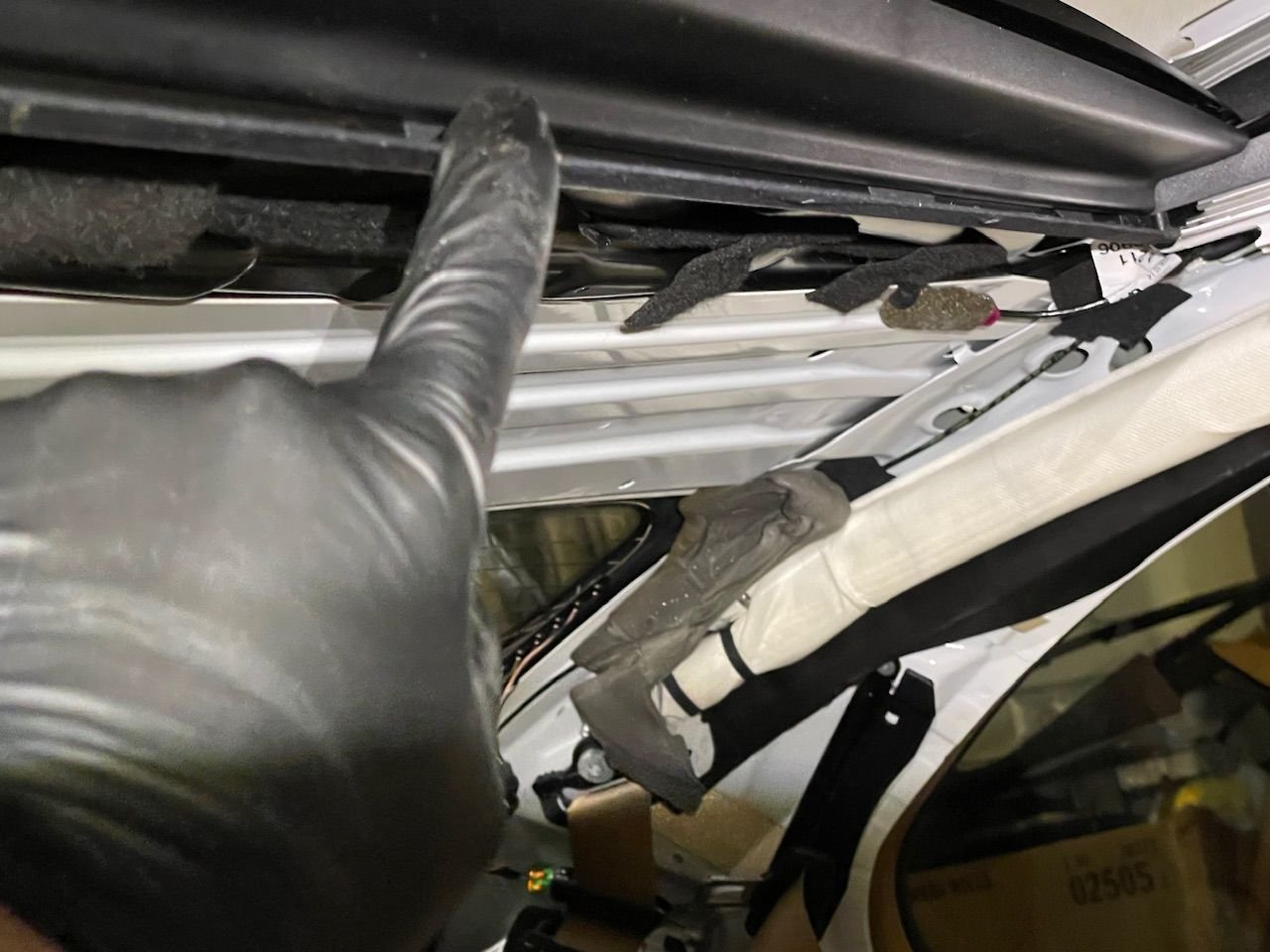

This is the HL Rearward Edge as seen via my boroscope that I fed through the HL by the Passenger Side Rear Door.

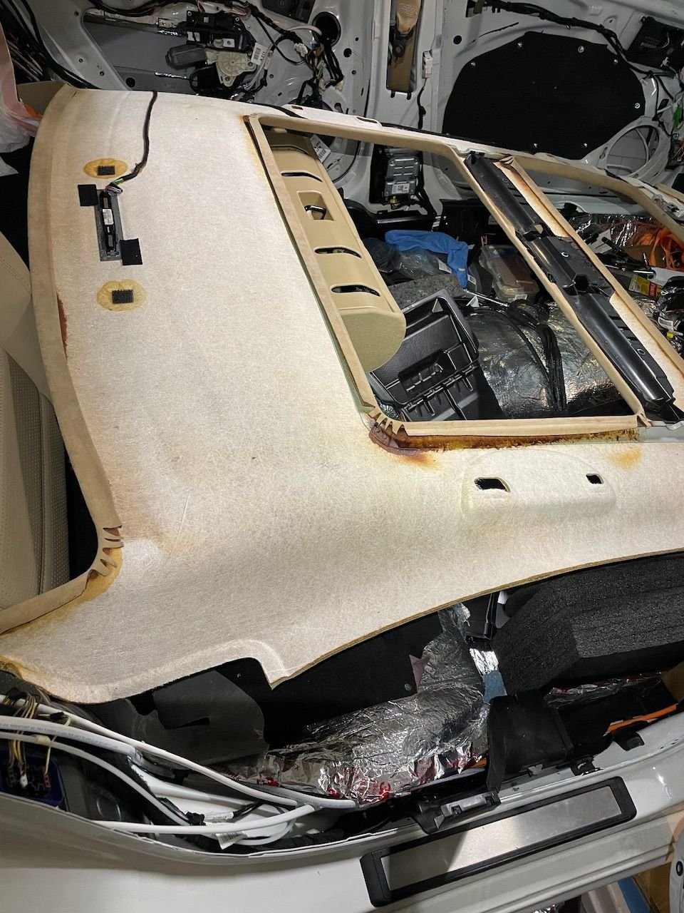

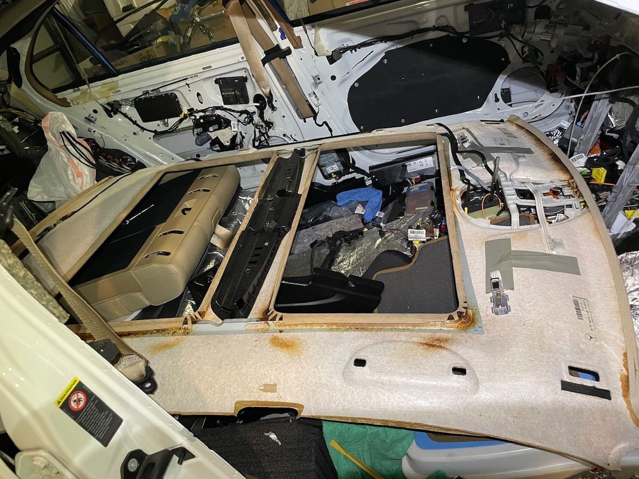

This is the Pano HL just after it dropped!

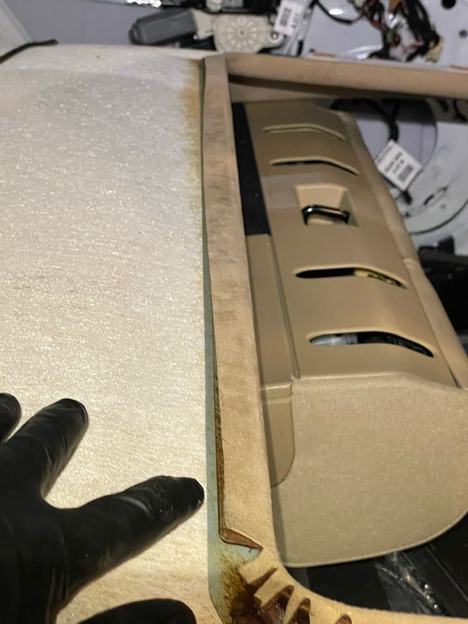

A more close-up view of the Front Edge which must be wedged up into place along the front edge of the Pano Frame (ie-just along the front edge of the SR Opening!)

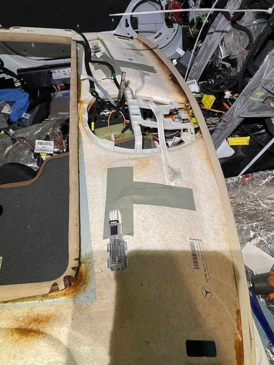

The Rear most Edge of the HL.  This is a similar view of the Rearward Edge only take via my iPhone instead of the lame pic taken from my Chinese made Boroscope!
The Rear most Edge of the HL. This is a similar view of the Rearward Edge only taken via my iPhone instead of the lame pic taken via my Chinese made Boroscope connected wirelessly to my iPad!

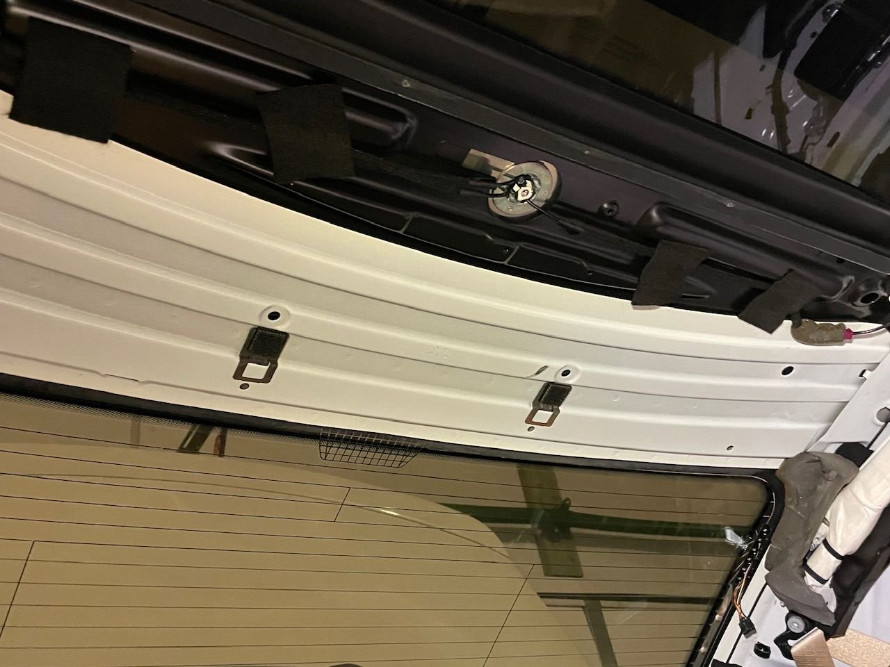

This is the Rear Edge which the HL must be first attached to upon install.
These are the industrial strength Velcro pieces in the rear which will be the last things you attached upon install.
In this view you can see those two “Velcro” squares R&L of the Parking Proximity Light.
