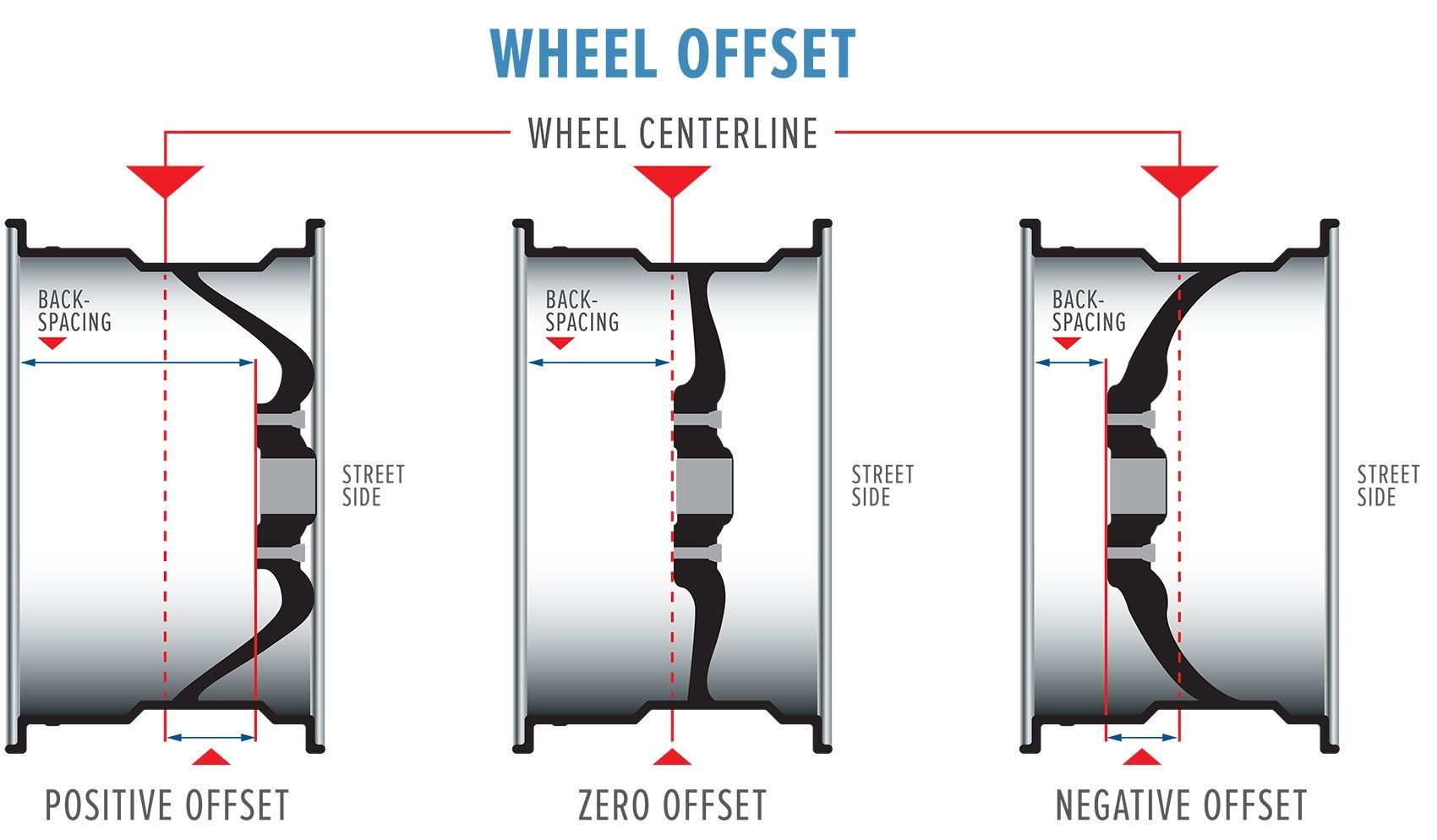

It's the same. The coupe just has wider wheels/tires, so the center of the wheels are pushed in further, shortening the track width. Outer edge to outer edge of the tire is the same width.

Well, the above diagrams you posted are with different width wheels. The measurements won't apply to a C200 coupe with narrower wheels. You have to get the actual measurements for the C200 with same size wheels. Those wheels will also have different offsets so that they are pushed out enough.

Yeah I know offsets and stuff, I have some history with old Beemers and ridiculous looking stances. Just confused by the seemingly official diagrams (and multiple car info sites) stating such info that renders absolutely useless, as one can't know what type of wheels it was calculated with (width or offset). My logic says they would use the same wheels for comparable measurements but for some reason they didn't.
