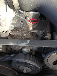

ummmmm....... on further investigation, it appears I may be missing a part (see photo)
Isn't there meant to be a tensioner or something where the red arrow is?
And if so, why hasn't the belt come off?
I need the VIN# to answer this question.

It's a C200 Elegance W202 1998 with aircon etc.
Strange thing is, I've never been anywhere near that so it can only be:
1. The car didn't come with it in the first place?
2. The garage left it off during a service etc many moons ago?
Old May 29, 2013 | 07:36 PM
I need the FULL VIN# to answer this question.
whunter@pelicanparts.com
