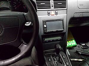

Here's mine, did it a long time ago. I just got a new unit to replace my old pioneer d3.
http://www.crutchfield.com/S-OJ3YYrX...on-DNX692.html

how hard is it to move the cofort controls? are the wires long enough to move from the top to below the radio?
also does it just "sap inn" or does some sort of fabrication have to be made?

i know it isn't the version with the climate control, but i just took the front of another w202 and cut it up to fit, same for the frame and bolted the radio in place, i did had to lose my cigarette compartment, but still worth it
