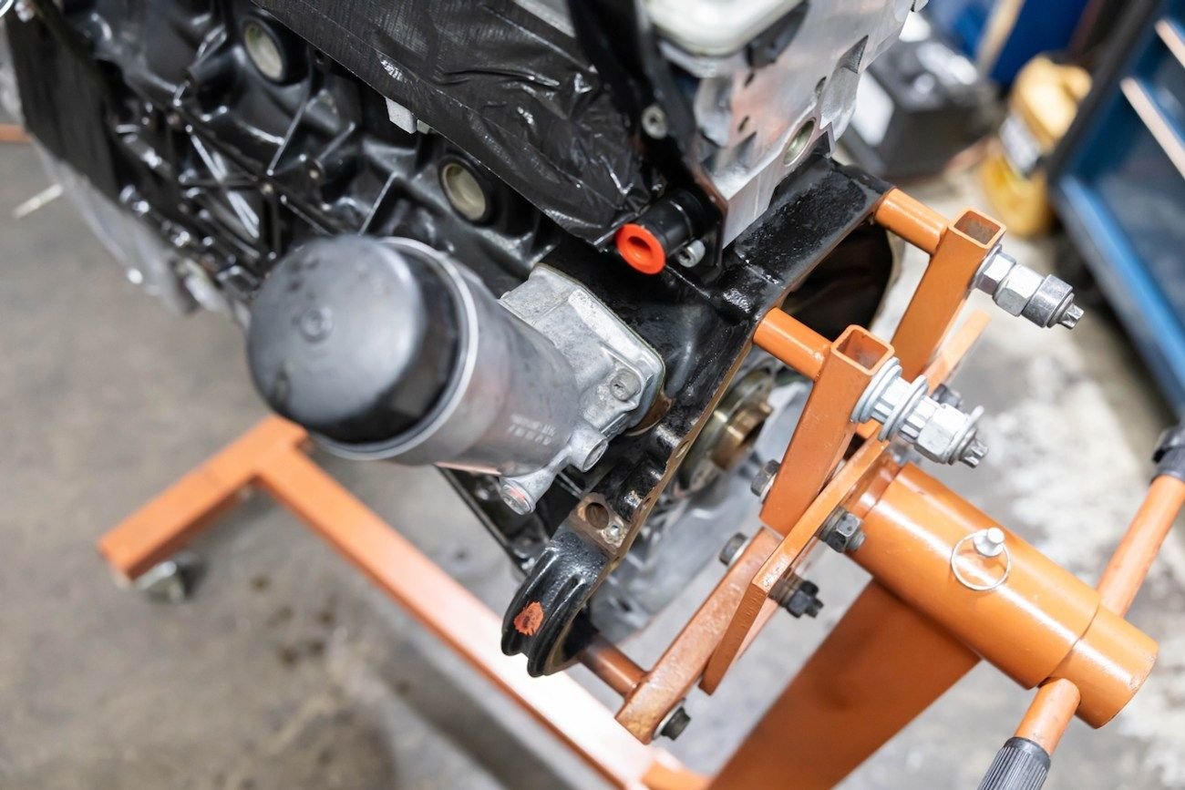

Anyway, a Snap-on scanner said "crankshaft position sensor signal L5 not recognized/implausible", so I thought I'd first check the connection and then replace it if necessary. I don't remember seeing it while replacing the injectors. Does anyone know where it is located?

without a VIN----look to the drivers side lower back of the engine where the transmission bolts to the engine!!

Since I couldn't find a graphic answer to this anywhere - I looked up our m104 engine for sale and found some nice pics. The crankshaft position sensor goes in that hole you see above where the starter should be - and under the oil filter housing.
