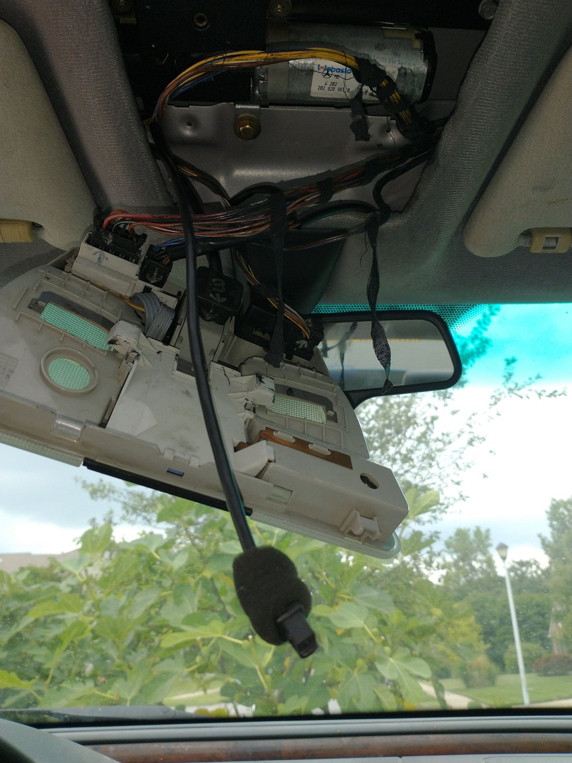

Anyone know where this wire connector goes? I got the headliner replacement done and reconnected everything but apparently I did not take note where this wire went. I think it belongs above the headliner in the front side because all connectors I unplugged are accounted for. I just noticed this late after I reconnected everything to the overhead dome light console.
Don't know where this wire connector plugs to.
Same wire connector. It has foam wrapped around it.
