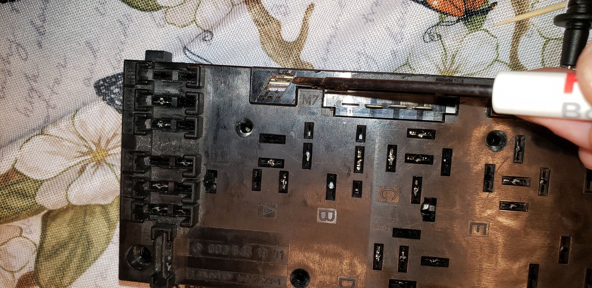

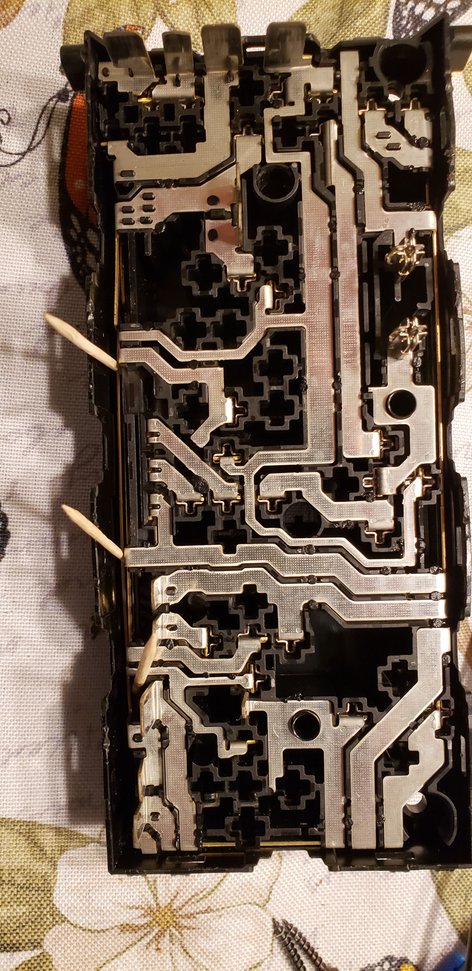

Turns out that mechanic was not totally truthful. The issue was caused by a sharp object being jammed into the drivers side fuse & relay block thus pushing the C2-2 rail into the C1-2 rail and putting the car into key on mode permanently. I took the block apart and put an insulator between the 2 rails and now the problem is gone.
This is where the block was penetrated by some object pushing C2-2 into C1-2.
I pried it apart first to verify successful electrical separation with toothpicks.
