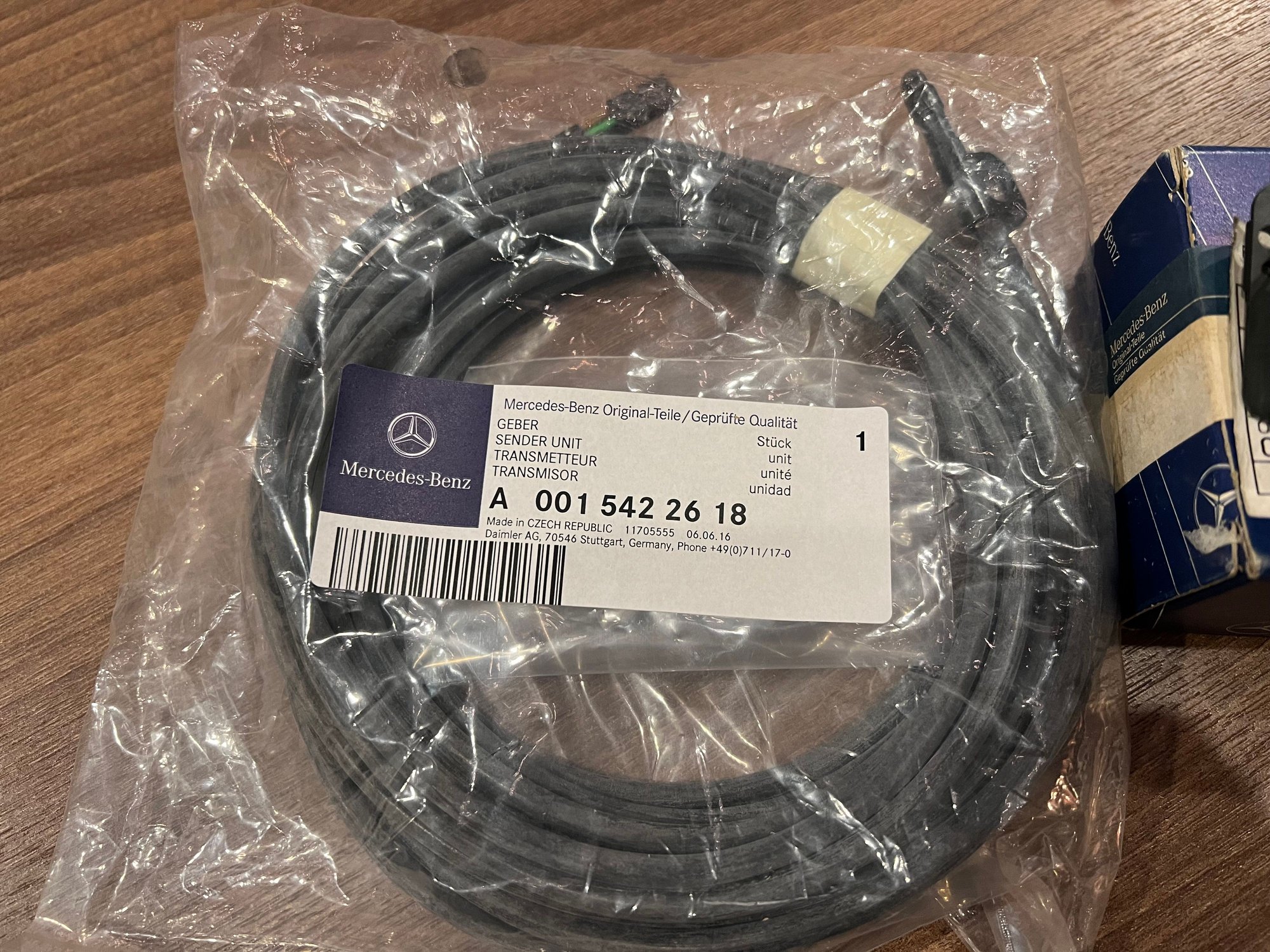

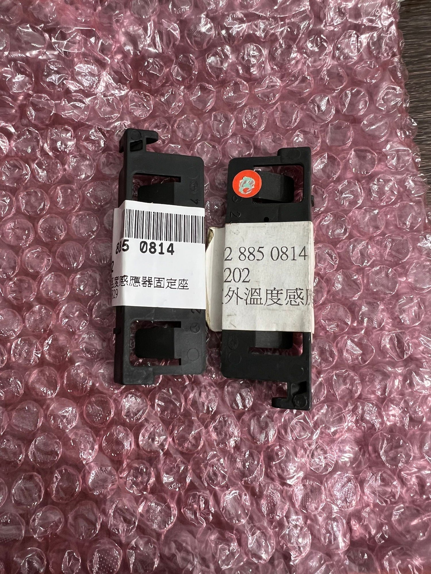

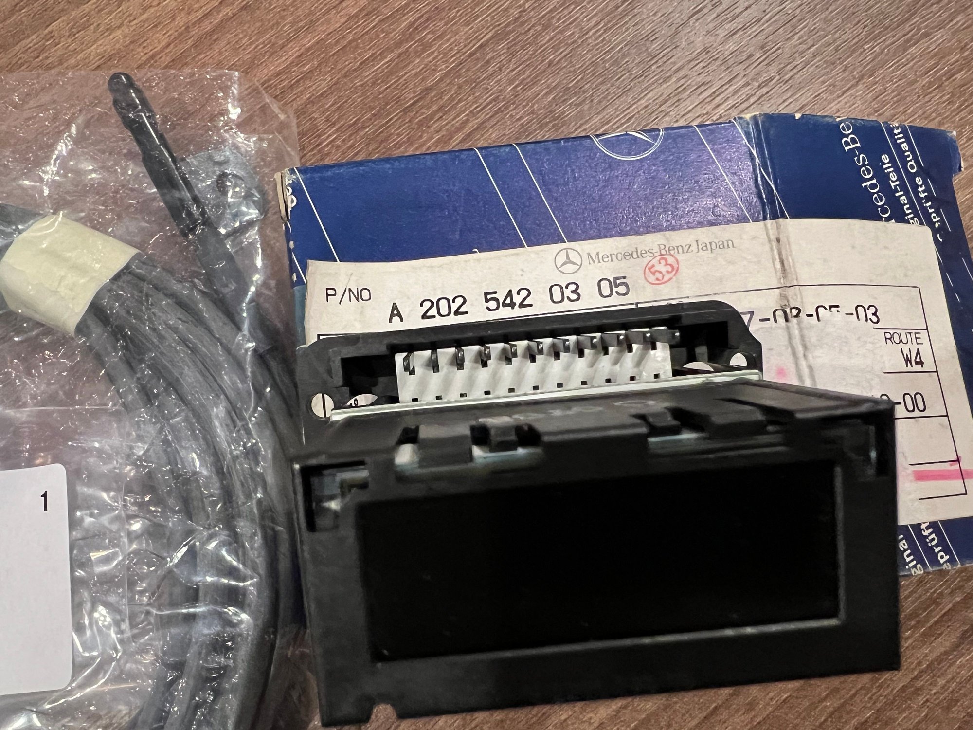

First, you must prepare these three accessories, temperature line set, monitor, and temperature bracket.
Temperature line 005452618, monitor 2025420305, bracket 2028850814
The bracket is used for W202 from 1994-97, as shown in the picture of the red C36. Because my appointment time with the car repair shop hasn’t arrived yet, I can’t install it on the car yet.If you don’t mind, you can take a look at this website first
