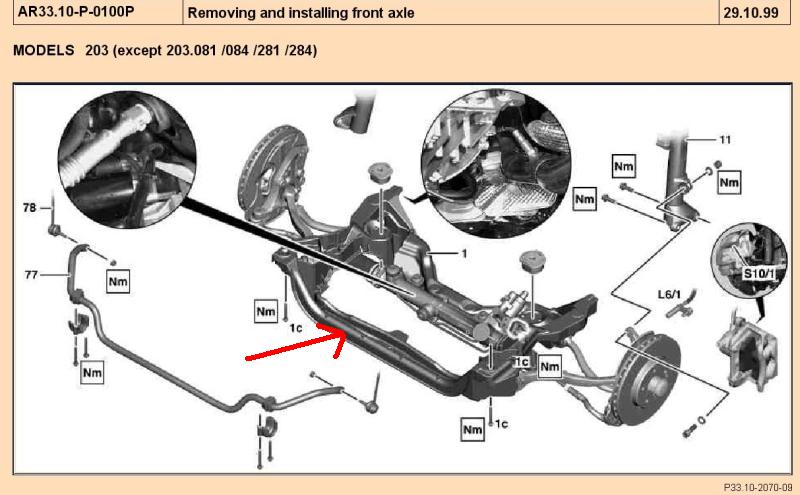

can anyone please tell me what the function of the part indicated by the red arrow in the pic is? also, can it be replaced independently if it was cracked? hope some of u guys have this techinical info.

Looks to be the front lower subframe. That is not a cheap part either. But I am sure with a lot of time on your hands and the proper tools and equipment you can replace it. Normally the only people replacing that piece would be a body shop's frame guy! That is part of the frame if I recall. Not the frame as in the old days, but the frame components that attach to the unibody and thus keep the vehicle rigid. That looks to be the one under the engine and the one that the lower A-Arms and rest of suspension connect to. As well as the one that should support the engine as well.

Are you pointing to the main steal portion or what looks like a bar bolted above it?

The arrow is pointing to the front subframe. It is aluminum, and yes it can be replaced. It's not a small job, though. The engine would have to be supported, the steering disconnected, the brake lines opened (to remove the axle assemblies) etc. So, I'm thinking the price of the part will pale with the labor involved. And, don't forget the alignment afterwards.
Sorry for the bad news.

ouch, i guess replacing it will hurt my pocket quite a bit. well, maybe i'll go with the mechanics advice, he suggested to just weld the cracked part since its not completely broken and then renforce it somehow. do u guys think it'll work? does this part bare a lot of wieght? i mean i dont want it to break off while i'm on a highway or something, that'll be the end of me.

Just beware... In doing that if some one is smart and has your car looked at when you are trying to sell it to them they will see that something happened to the car. That could hurt your resale value and may negate the savings from welding it... Just a thought...

Please don't mess with a load bearing part like that! It is a major load bearing part of your vehicle! So not only is it working during normal driving, but if you were ever in an accident, that part would contribute a huge amount to saving (or losing, if it was not in proper working order) your life.
No manufacturer recommends welding any suspension component. Please follow thier instructions, for your own safety and anyone who may be driving with you.

I have to agree with MBbodytech. That is part of the frame system in these cars and in an accident it could end up costing you your life. Now you could have it welded by a certified aluminum welder and it would be just as strong as before if not stronger most likely. But in my opinion it is not worth the risk to do that. And I would not trust just any welder as aluminum welding is a specialized type thing. Not just any guy with a welder can do it. I used to know a guy that way the best in NY State when he was like 22, but his dad owned a welding company so he had to be. He was one of four certified in the state at the time, and NYS is a big *** state. He did my brother's engine block mounting point on his Ducati when it cracked due to a drop of the bike. Looked like it was done at the factory when he was done, that is if you could find it. All depends on what you want to do as it is your car. Personally I would have it welded and never look back after I checked it out. If the weld did not look good or the piece started to look stressed afterward then I would replace the piece. But I realize that in most cases the weld makes it stronger due to the excess metal there. But that is me and I used to watch the guys in my dad's body shop when I was growing up.

[QUOTE=mctwin2kman] Personally I would have it welded and never look back after I checked it out. If the weld did not look good or the piece started to look stressed afterward then I would replace the piece. But I realize that in most cases the weld makes it stronger due to the excess metal there. QUOTE]
I have to disagree with the perception that "excess material" would make a welded part stronger. In some cases that may be true, but as long as we are talking about a cast aluminum subframe, there is no way that part should be welded, and it dosen't matter who does the welding, it will never be at the same strength as it was from the factory.
Also, there is no way to weld the subframe on this vehicle so that is would be undetectable, since it has a texture on the surface from casting it. It would be plain as day to anyone who might see it, whether they know anything about cars or not!
I don't understand how people get the idea that they have enough knowledge to make a decision that only engineers at the factory who have access to huge amounts of information and years worth of research are capable of.
Consider this: That part is the load bearing member for the engine and front susupension, and that area is the jack point for the front of the vehicle. This is a very abusive environment. You have vibration from the engine, forces from the suspension when driving, and massive temprature changes all working at this new weak point. It's not going to last! And then what happens when someone slides a floor jack under the front of this car, and all of a sudden the weld dosen't hold?
Also, dosen't the fact that a poor repair just caused a car to break in two remind anyone that there are some things that you just shouldn't repair?

He asked a question and I answered. I also said the factory piece would be the better way to go. And I would not even buy a car like that so it does not matter what I think really. If he was doing it for himself to save money then OK, I have no problem with it either way. And from an engineering stand point it all depends on the weld and welder as to if it would hold or not and of course the crack itself. Me I would replace it. But some people are not like me so to each there own. Where that piece is the car will not break in half so that is a moot point there. As for structural rigidity, that all depends on what is done to it and how big the original crack was. I have seen factory welds break and have seen cars come from the factory with no weld what so ever in certain places. And I have seen factory cars with welds where they should not be and are not on any other car. So to say that it would be more likely to fall apart or fail is laughable since the factory sometimes does not even do it. My brother drove a car once for months wondering what the noises were and why the body felt to shift when turning. The factory missed over half the welds tying the body to the frame rails and parts of the unibody! Kind of funny actually that the company is now owned by Dailmer that this vehicle was made for. Either way it does not matter to me what he does. You run the risk when you buy a Salvaged vehicle that it is not going to be perfect.
