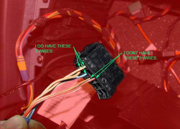

COMAND WIRING QUESTION LOOKING FOr SIMPLE ANSWER
I have a comand unit from Steve and he ran out of Adaptor Harnesses, so hes sent me one (been 2 wks!). Australian Customs computers have gone crazy and they've announced major delays, yes im impatient! Soo....
I have taken my car apart for a dry run, and i have a question about possibly installing the unit WITHOUT the Adaptor Harness.
Q: In the pic attached it shows the existing 'C' cable/harness from the car. Now i dont have these 2 cables.
C pin 5 (red/blk CD changer +)
C pin 6 (brn CD changer -)
(photo was taken from the benzw0rld publication, and i modifyed it in Photoshop)
Soo...As it says above, does the 'CD Changer' mean the 6 Stack cd player in the glove compartment? (my car did not come with the cd stacker option)
NOW
If i am right in saying that i dont have these two wires because i dont have the cd stacker option....
Q: Do i need the 'C1' Connector at all?
Sorry for the longish post and Thanx
Attached Thumbnails COMAND WIRING QUESTION LOOKING FOr SIMPLE ANSWER-connector-cars-wiring-own-loom-red-.jpg

a c1 is then not required as it houses the power and ground wire to the comand.

You dont need the adaptor or C1.

Thanx Sunil / Thanx Miro.
Just another thing...
Will i have to cut/splice the 3 wires and crimp them so that they will fit into the pin housings of the 'C2' connector? Or Is there a way to get the wires out with a screwdriver like with the inner part of the 'C2' conector that Steve Supplied me with?
The ISO pins dont fit into C2.

if you don't have the cd changer in the glove box, those wires are not necessary.

Thanx...
So is there a way to get the ISO pins/wires out of the Housing (pictured in my first post) without having to cut the wires?

And what are you going to insert those pins into ? So the answer again is no way.
I take it that you intend to remove the COMAND and sell it when you sell the car. So you are trying to avoid permanent changes.
On the last two trips to Melbourne I would have installed a parallel wiring harness only for COMAND and tied back the original radio connector but since you only offered me $35 USD to install and wire the COMAND system then I guess there was no room to move.

DC Benzo,
I would suggest you have someone else do the wiring as crimping the pins requires a special tool. 35USD to install the comand? You must mean to place the remote in his glove box. the connectors and pins alone are worth that much.

...just wait for the adapter harness or cut the wires off - crimp the suplied pins on and insert those into the C2 connector to hook up the comand...
