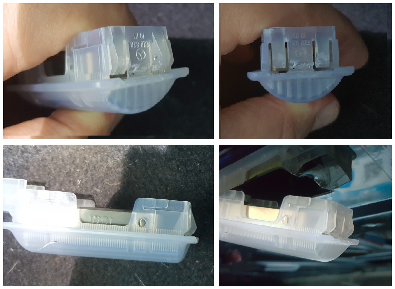

Old thread I know but it is the one I landed on.
Here are some pics of the trunk light from my 2003 c230k sedan for those that are are struggling to remove theirs. I resorted to moderate brute force... sucky thing is that there is no voltage at the connector and the bulb is fine. Is there a fuse number for this and where is the actuator for the light?
