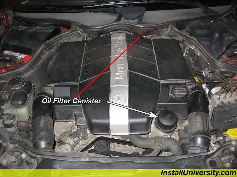

where's the oil filter?????
On top of the motor. I will get the photo's up tonight for you. I have been struggling with the transmisssion plug gasket writeup and a few other things. Look back in a few hours and I will have the pictures finished in my document.
In the meantime, it is the canister near the front, on the dirver side of the engine compartment.

Hope this helps. Just unscrew and yank the o-rings and filter off. Replace the big o-ring, then the filter, then the rest of the o-rings. Make a not of where the o-rings are located. I think they send an extra one sometimes in the pack and that can really goof you up if you are not expecting it.

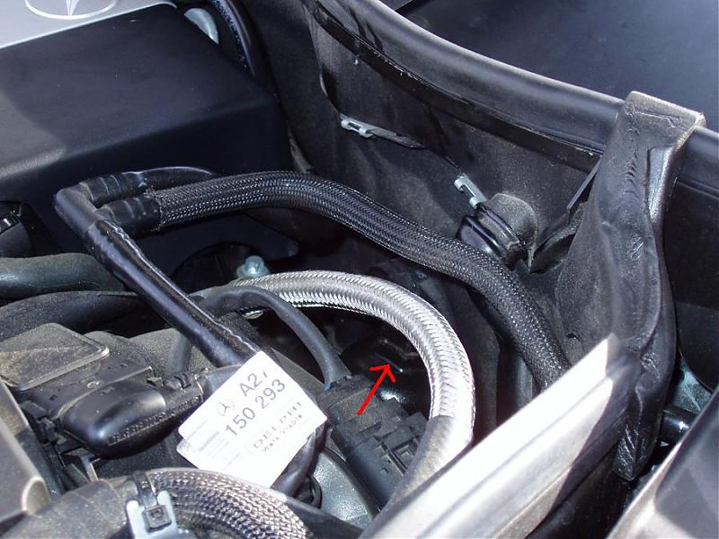

thanks for the reply, after a long search under the hood (at least an hour) ....i finally found the oil filter, my car is a 2005, so the placement is different, it's actually hidden near the firewall, around where i circled in red I hope more people add to your site so other models can be represented. Thanks again

maybe next time i change the oil i'll write up a DIY! This is the location for a 2005 c230 kompressor...

What a PIA to get too. Do you have a shot of your whole engine compartment?
