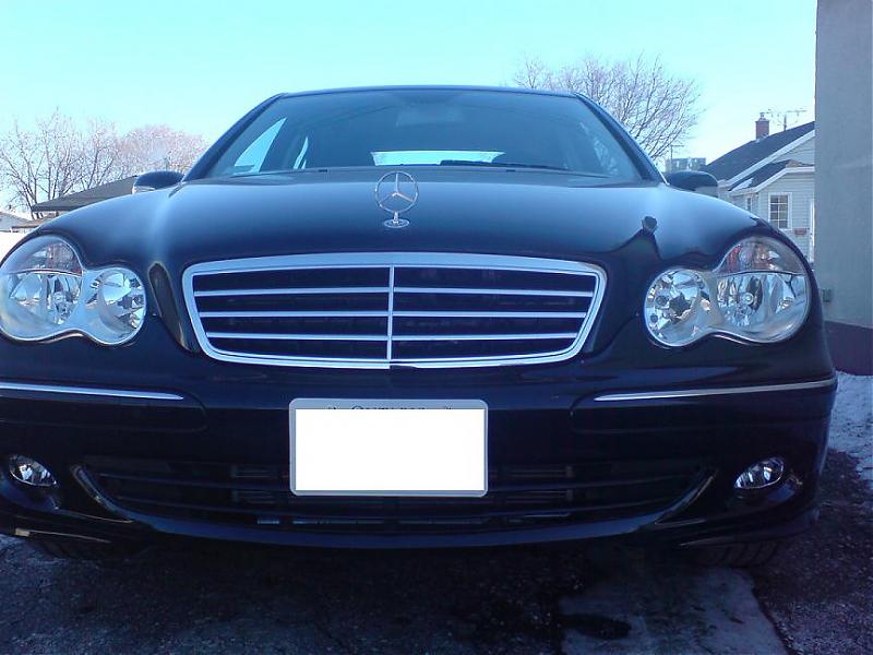

are these HID??
if so, then all i need is bulbs... if not then what would be a good HID conversion kit?? thanks

no, they are the stock OEM halogen housings for the newer W203 sedan

wrong. the picture is of a halogen reflector headlight. the worst thing you can
do is to install an HID kit designed [sic] for a projector based headlight. even
so, they HID kits are practically never calibrated for the projector.

D2S bulbs are for projector based housings. D2R bulbs are for reflector type lenses. D2R bulbs have parts of the bulb covered in a black coating.
raymond g - I don't know about all the kits out there but the one kit i've seen was a re-based D2R bulb like it should be for refective housings.

Folks, Raymond is right.
There are many kits, none of them have even come close to meeting the specifications of FMVSS 108. The reflector in Halogen housings is not correct for HID. Even with new bases on the lamps, the light source is not in the right position.
Save your coin to get the proper housings and lamps. MBenzNL.com is a trusted source for the Bi-Xenon lamps for a ton less than the dealer.
The kits that replace the halogen lamps are like putting lipstick on a pig. It does not look good, and the pig doesn't like it.
There are some questions you need to ask any one that sells kits to convert to HID lamps:
Is the conversion beam pattern correct?
How is the conversion made to be beam pattern correct?
How is the conversion tested to ensure beam pattern correctness?
If it is not beam pattern correct, can they tell you how to fix it?
Do they know what a correct beam pattern looks like?
Are they aware that non-beam pattern correct conversions have serious disadvantages? A person could get hurt!
I can't see how a bulb designed for a projector housing can be installed in a reflector housing and get a proper beam. Since the lamps must have their base changed, it might be possible. Mid 90's Mercedes actually had such a lamp, but it has fallen from favor. One big problem with putting a HID lamp in a reflector is the insulation of the return wire. Most reflectors are metalized, and will arc to the return wire.
The color temperature of the lamp is either 4300K or 6000K. Only 4300K is used in OEM headlights. How would you measure it? Knowing that most people can't, sellers lie. The way they make it blue is to put a filter on the external glass. This raises the color temperatue, but decreases the light output significantly.
My experience is that Osram (Sylvania) or Philips HID bulbs get more blue as they age, and they last about 2,000 hours. Asian lamps (unknown manufacturer) seem to remain rather constant in color, but expire at about 600 hours.
Conversion to Bi-Xenon is possible, but you must change the housings. MbenzNL.com has more infomation on factory parts. These lamps will probably not be available much longer because of the production of the new C class body style (W204), so you should move quickly if you really want them.
Changing the housings is not the full job. You do need the computer to be version coded for xenon lamps. This is because halogen lamps draw 55W and most HID lamps draw 35W. The car can tell the difference.
In most aftermarket installations you don't get the automatic leveling sensors and sensor wiring harness, nor the heated headlamp washers. Both of these require a lot of very expensive additional parts. Many folks don't think these items are really necessary, but be aware that Federal Motor Vehicle Safety Standard 108 requires the leveler and washer. It is your choice.
