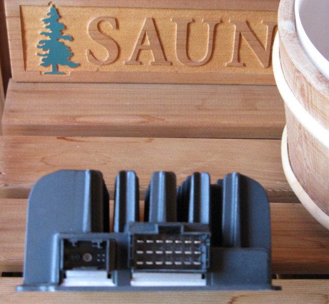

First, lets clear up a few misconceptions about the sound system. The sound is pretty darn good. You will spend huge money to duplicate it with after market components. After market stuff will not integrate the same with steering wheel controls and the multi-function display. The speakers are tuned for the car, and are connected by wires from the amp. There are nine physical speakers with a Logic 7 system. The MOST fiber optic cables carry the sound data from the head unit to the amplifier. There is no no fiber optic connection to the speakers themselves. The input to the amplifier is, however, only via fiber optic cables, so a new head unit from an after market source would need a MOST fiber optic output.
I am suspicious that the problems you mention are caused by the output connector to the speakers. This is a Tyco/Amp connector that has 21 tin pins to carry the voltage to the speakers. Tin has a problem with corrosion. Living in Florida, you are aware of the moist humid salt air. It might have caused contact problems with the connector. The poping of the speakers and the volume changes lead me to suspect this. There is a microphone above the front seat passenger's head that is connected to this connector that is used to adjust the volume based on ambient noise. (notice they placed it near where the woman usually sits.) The photo shows the 21 pin connector on the right. You can clean it with isopropyl alcohol.
The connector on the left is for the two MOST fiber optics cables and the four pins are for power and the "wake up" signal.
You will find the amp on the right rear wheel arch under the carpet in the trunk.
