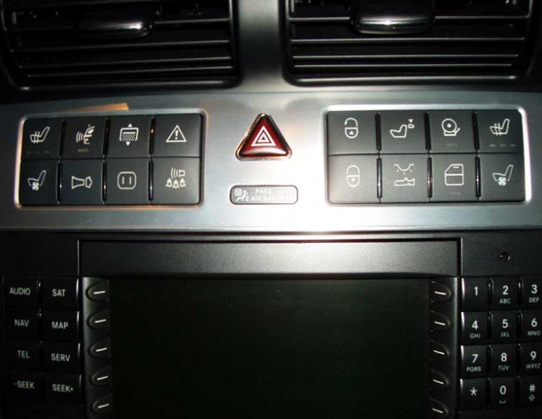

Installed...
Thanks!

Looks like an easy mod, very clean.
