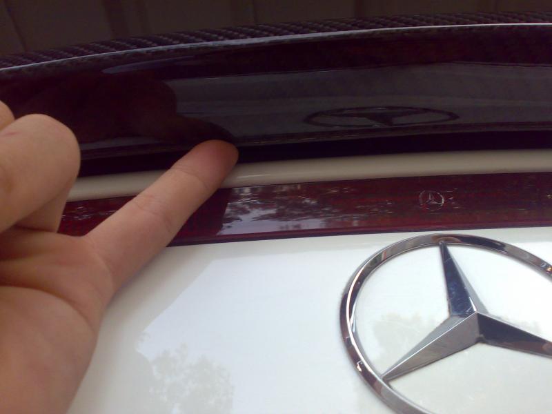

so after getting my wing i did a 1 hour job just putting hard *** adhesive. i dunno if i was too excited or im doing something wrong coz when i mounted it theres a gap on the third brake light.. but when i was fitting it there was none.. so im 100% sure its not a fitment thing.. what is the proper way of mounting this thing? left to right? vice versa? or center first? pissing me off coz now i have to remove the ashesive that i just put... then do it again..

i dunno if this will help... but when i mounted my renntech spoiler i made a slight mark on the car and on the spoiler to find the center... then i mounted the center first moving slowly and checking the sides along the way. seemed to work pretty well.
if you go left to right or vice versa... any small errors will propagate and most probably end up worse in the alignment in the end.

ok.. spoke theres still a little gap... spoke to the place i ordered it from and they said thats really how its suppose to be.. frankW i know you have one same as mine.. does it really have a gap? ontop of the third light?

mine has bigger gap.
and NO. it shouldn't have any gap.

try putting a piece of corrugated plastic 1/8" there, but a piece of double stick on both sides of the corrugated plastic. I've done that to my ACS replica spoiler on my 5er
