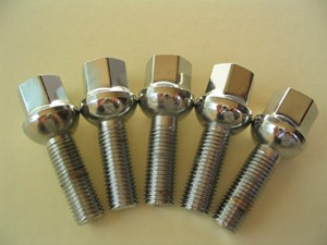

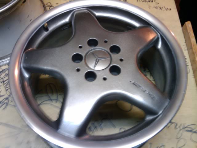

Can anyone educate me about bolt head!!!!!!!
I have W208 CLK AMG rims on my car 2005 c230, just wanna make sure i bought the right bolts for my rims. BTW my car has a little vibration when i go over 65mph.
Here is the bolts i got: Lug Bolt 12x1.50 Ball Seat 50mm Shank

Mercury you are fine. CLK wheels are interchangeable with our car, partly because of bolts.
In my case, the E Class uses a M14 bolt head, not an M12 head, and is shaped differently. I also needed spacers. So I had to get bolts at the right length, thread, and with a M14 head. Fortunately the shop I was sent to by my dealer has lots of combinations of bolts for these situations. They also have an in-house mill shop so they can manufacture anything from bolts to custom spacers.
