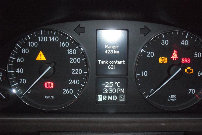

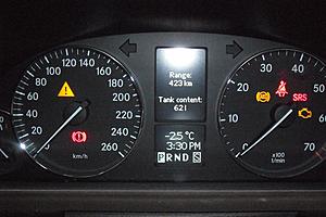

Originally Posted by OneOfaKindTrini
Is this what you guys are trying to get..?
If you read any of the thread you would see they are trying to get it to say how many gallons to empty.
sorry mister perfection, I only got through the first page then I posted at the bottom
Maybe you should put some more effort in and read the 2 other posts on the second page so you dont look like an idiot taking a picture of the factory range screen on the dashboard and then posting it to a thread that says "Gas tank MOD with Star" and asking if this is what they are talking about.
And .. Oh yeah it's January 30th and 47 degress F outside {thumbup}
It's not that important bro, it was a mistake on my part.

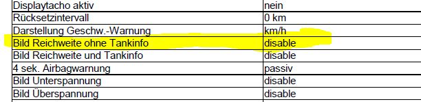

Hey guys, this is how the menu looks for the pre-facelift models. It's the similar process but instead you change these.
Searching for tire loss warner. I believe I did two versions.
