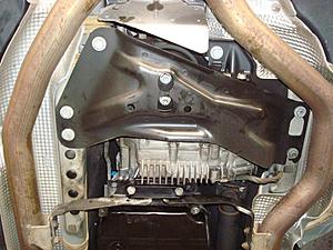

Hi,
Would some one with WIS manuals, please post the WIS instructions for replacing transfer case fluid for a 2007 C280 4Matic (M272).
Appreciate your help.
I looked under the car, the transfer case is really buried up there. I don't see how I can get to the fill hole without removing trans mount and cross member... please help.
thanks for your time.

from what i remember you DO need to remove those to do it its a real PITA
I need to do mine too

Here is the picture... the black cross-member in the middle of the picture will need to be removed, I think. The problem is, the transmission mount is attached to that cross-member. So, if we are going to remove that cross-member, we'll have to support the transfer case with a jack and remove that cross member and the trans mount. Even after that, it doesn't look like there is much room to access the fill hole. The drain plug is accessible.
WIS please?
