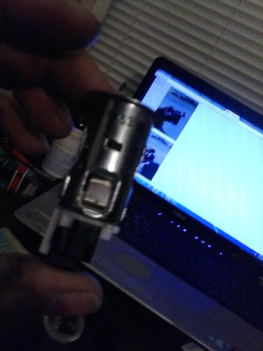

So, I finally was able to disconnect the cigar lighter and the fuse still popped. I dissconnected the tap into the cigar lighter and the fuse didn't blow. I reconnected the cigar lighter and the fuse blew again. So I can't even put a load on the wire with out it blowing. The wire looks to be intact and I don't see any breaks, still need to dig a bit further. Any ideas?
Originally Posted by ALLDATAdiy INFO
Looking at ALLDATAdiy.com I see that Fuse 47 is also for your Glove Compartment light as well. May want to check the wiring or bulb in there too.
The light works when I open the glove compartment, so not sure what else to check.
A pic I found on how to disconnect the plug. I was trying to pull it out, but you had to push it out from the side,
